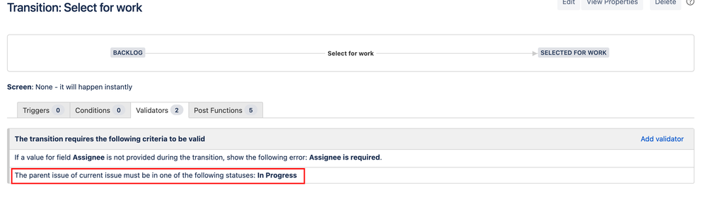

Hi, I'm trying to prevent sub-tasks from transitioning to "Selected for Work" if the parent task is not "In Progress". So, I chose the tool "Parent Status Validator" for my sub-tasks workflow as below.

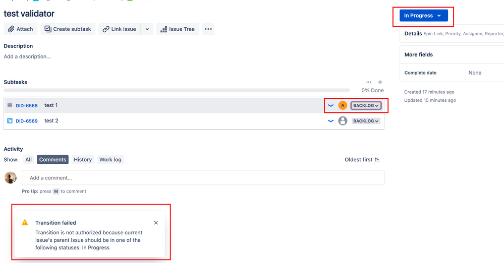

However:
1. it's showing an error "Transition is not authorized because current Issue's parent Issue should be in one of the following statuses: In Progress". But from the below screenshot, I can clearly see parent task's status is already "In Progress".
2. After testing, I noticed it only becomes an issue when I apply "In Progress" for the validator, all the other statuses work as expected
Can someone help me with this issue? thank you!

jiang gao
May 2, 2022
After talking to Jira supporting team, it turns out the issue is caused by there being multiple "In Progress" statuses from other team-managed projects. and the validator is mistakenly comparing the statuses from other projects with other IDs.
the workaround is changing the "In Progess" to a unique new name such as "InProgress" for my case.

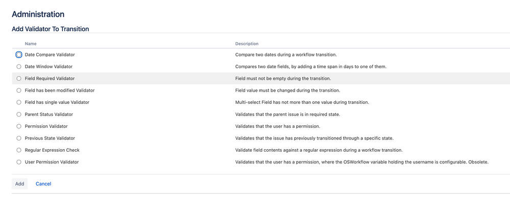

Hi @Fabian Lim, thanks for replying. But I'm not using the JMWE, and also there's no "Related Issues Status Validator" in my validators list. I guess they are all the native ones from Jira Cloud.
