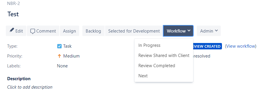

I've created a workflow for a project.
Here is the workflow:
Backlog, Review Scheduled, Review Created, Review Shared with Client, Review Completed
ISSUES:
The Issue screen does not reflect these statuses when selecting'Workflow' to view the dropdown.
The Issue screen has a 'Selected for Development' button. Why? This is not part of the workflow above.

@Vipin Sroya, the buttons reflect the transitions of the workflow. so you must have that transition somewhere on the workflow. If you are still having issues maybe provide screenshots and reference where you are having issues.
Vipin Sroya
October 2, 2018
@Jack Brickey Please see below for screenshots
Vipin Sroya
October 3, 2018
I have figured this out. I had to create a new workflow and added the same statuses. Apparently I was working off/editing an existing workflow and that's why the buttons (selected for development, next) were all showing on the Issue screen.

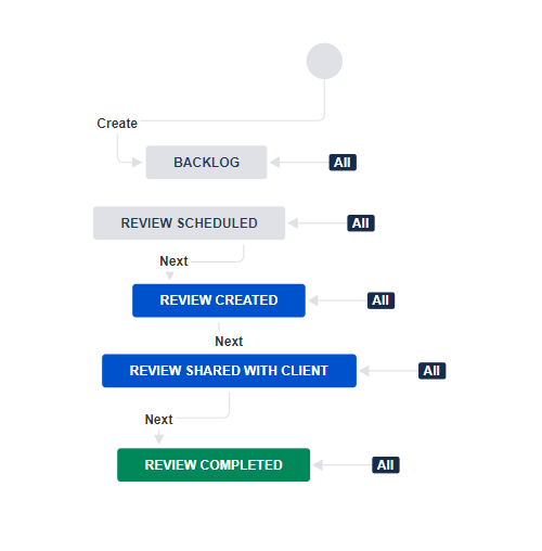

Mohamed Benziane
October 2, 2018
Can you go to yout project setting>workflow select your workflow click on edit and show trqnsition. What do you have, can you provide a screenshot
Vipin Sroya
October 2, 2018

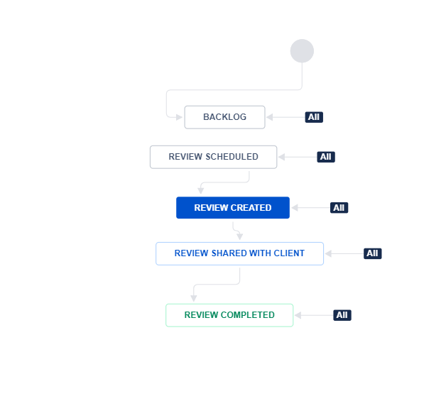

Vipin Sroya
October 2, 2018
Here's both problems on the Issue screen (not reflecting my workflow above, and displaying a 'Selected for Development' button:workflow2.PNG
Nic Brough -Adaptavist-
October 2, 2018
The only way that can happen in Jira is when the workflow you are looking at is different to the one associated with this project and issue type.
Or there is something horribly wrong!

Vipin Sroya
October 3, 2018
@Nic Brough -Adaptavist- @Mohamed BenzianeYes, the view workflow hyperlink shows the same workflow as in the picture I posted when editing the project workflow.

Vipin Sroya
October 3, 2018
Can't be a different workflow. I get the same workflow when clicking the (view workflow) hyperlink:
October 3, 2018
Could you hover the cursor over each of the arrows in turn.  If it is the same workflow, then you find that the buttons on the issue have the same names as the arrows.
Vipin Sroya
October 3, 2018
@Nic Brough -Adaptavist-The arrows just show Next. I think the problem may be that I'm on a simplified workflow, and not a Jira workflow? How do I switch over?
October 4, 2018
The diagram you've shown is not a simplified workflow - the arrows between status have been added.  However, could you hover over each of the arrows coming from the "all" boxes as well.  One of them will be called "selected for development"
