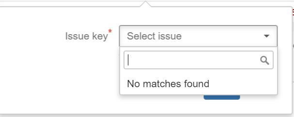

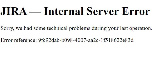

Here are the two errors I get. The first one is when I try to open up issues for the project. The second screenshot is from the workflow view. Do you need anything else? Thanks.
The internal server error is absolutely not normal, especially on the Cloud where apps simply cannot cause them (because no app code runs inside Jira). You need to reach out to Atlassian support.
As for the second screenshot, you should see a list of the last issues you visited. So there is definitely something wrong with your Jira instance. And I guess the first error can explain the empty list (the REST call that fetches the list of issues must be failing).
