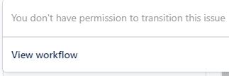

I have Sub-Task Blocking Condition set to prevent closing a parent issue when any of the sub-tasks are not closed. It successfully hides the transition status, however it does not give the user any indication as to why they can't close the ticket.
How can I add messaging to indicate this? Preferably via the default message in the Status area.

Conditions don't have any way to display why they are removing the option to transition - they're designed to de-clutter - don't offer options to do things that you can't!  You could use a validator instead, but these are less friendly than the condition - they would let the user trigger the transition and then scold them for trying.
I'm afraid the right answer to this is to educate your users on how things are supposed to work and review your process.  Ask them why they are trying to close things that are not finished?
