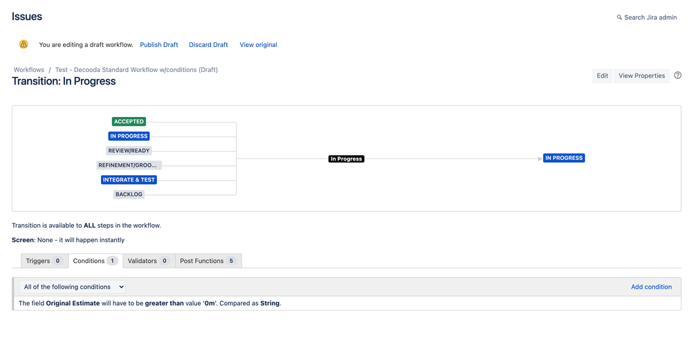

I have successfully created an easy rule that forces them to add an "Original Estimate" before pulling an issue into "In Progress" using this simple condition:

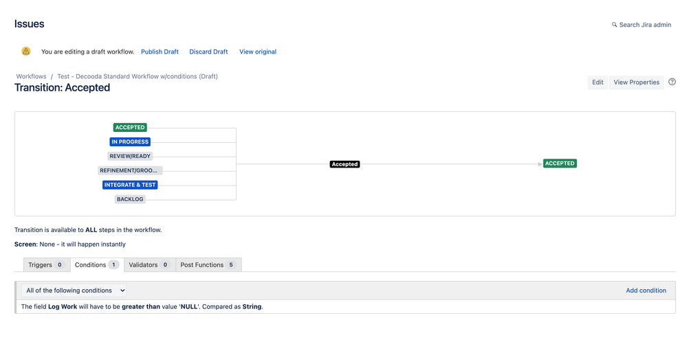

Where I am having issues is forcing someone to "Log Work" before pulling issues into "Accepted". I am using the same condition so I dont understand what my issue is, please see issue below.

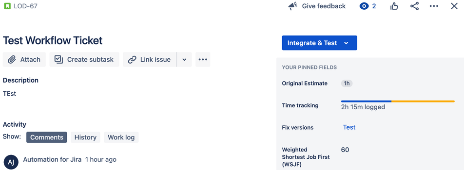

Here is a screenshot of a test issue that I logged work but I am still unable to pull the issue into "Accepted"

H Brett - Maybe I am missing something, but in your test card the value for Log Work (time tracking) is not null - it's 2h 15m. Which means it SHOULD be allowed to move to Accepted.
Yea, thats why I am stuck. I don't understand why it will not allow me to pull anything into accepted because I am logging work.
I cant set that field as a condition for whatever reason, but I have filled in the time tracking field/log work field every way I can think of with no success

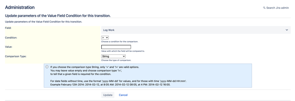

When I create a condition "Log Work" is the only time tracking field besides "Original Estimate" available to select in the drop down.
I've tried logging time 3 seperate ways with no success, by using the "work log" option by the comments, i've filled in "time spent" and i've used "log work" in the drop down on a ticket that gives more options. All of these added to the "Time Tracking" field but none have allows me to pull the ticket into "accepted"

I've tried >0 and >null, I cant use other values as Time Spent and Time tracking are not selectable fields for these conditions. The only option I have is Work Log.

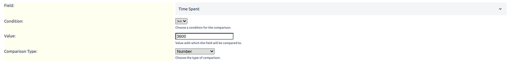

Hi @Stefan Anghel !
This is a bit tricky!
In the scrollbar, you can not select "Time spent" BUT you can type "Time spent" and you will see the value field.
Value is expressed in second.
Have a good day!
@Célestin Mansouri-Deveaux thank you so much, that was it.
Now I have configured a condition on the transition using sum Time Spent > 0 as Number and it seems to behave as desired.
