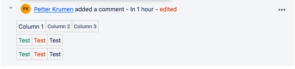

Can you please provide us a gif/video of how the user changed the table? In my test instance, the code to change the color of the A2 cell was correctly added:
|Column 1||Column 2||Column 3||
|{color:#00875a}Test{color}|{color:#de350b}Test{color}|Test|
We will be waiting for your answer to better understand the problem.
