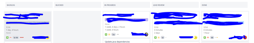

I have a scrum board for one of my teams, it has 5 columns, each containing a few statuses.
The Done columns houses 'Completed' status types, and in this case the ticket to in the Done column has been marked as resolved. The Done column is the rightmost column of the board.

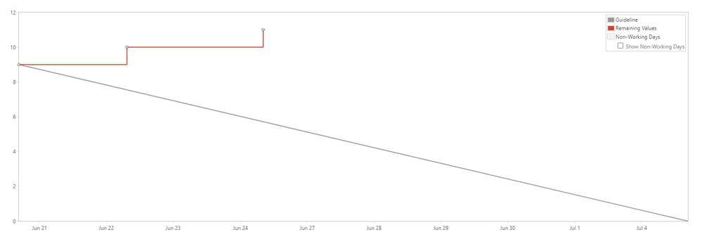

When I view the burndown, I expect to see the Done item burned down (burndown by issue count is shown) . I see the items I added to the Sprint, but am not seeing the one that should be marked as completed.

I've made sure the Done status is a 'Completed' Status, that the ticket has been 'Resolved', made sure that the Done column is the rightmost of course. I Have refreshed the board & report since.

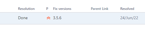

Thanks Dam, I did mention I have the ticket set as Resolved -  Resolutions status also 'Done'

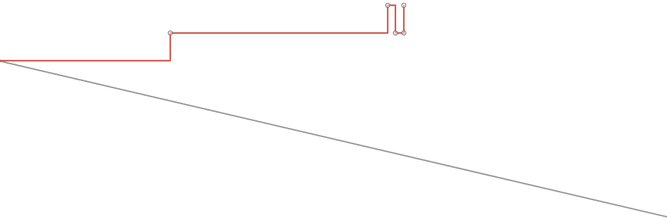

However the original story I've moved to 'in-progress' and to 'done' for testing, and it registered the initial move back to 'in-progress' as a sprint addition - but did not register the move to 'done' as an item completion
You can see in the chart where the 2nd ticket completed (was burned down) and the first ticket was moved back to 'in-progress' (chart spike up) but then there was no burndown when the 1st ticket was moved back to done. So currently this ticket only has the ability to "add scope" to our sprint
I'll continue testing other stories through the sprint. These 2 issues are of different type (defect burned down, story did not), but follow the same workflow and have the same fields completed
