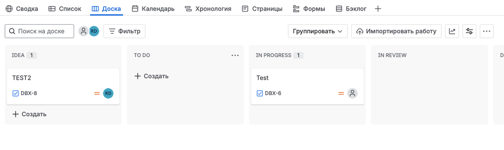

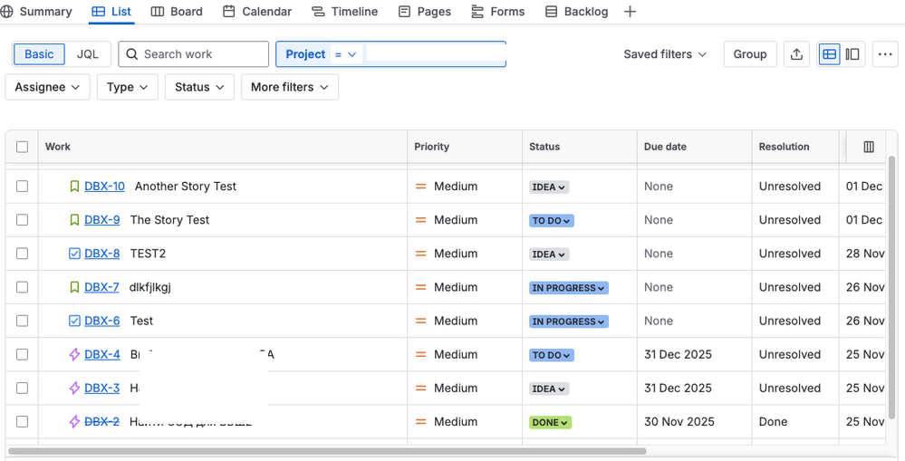

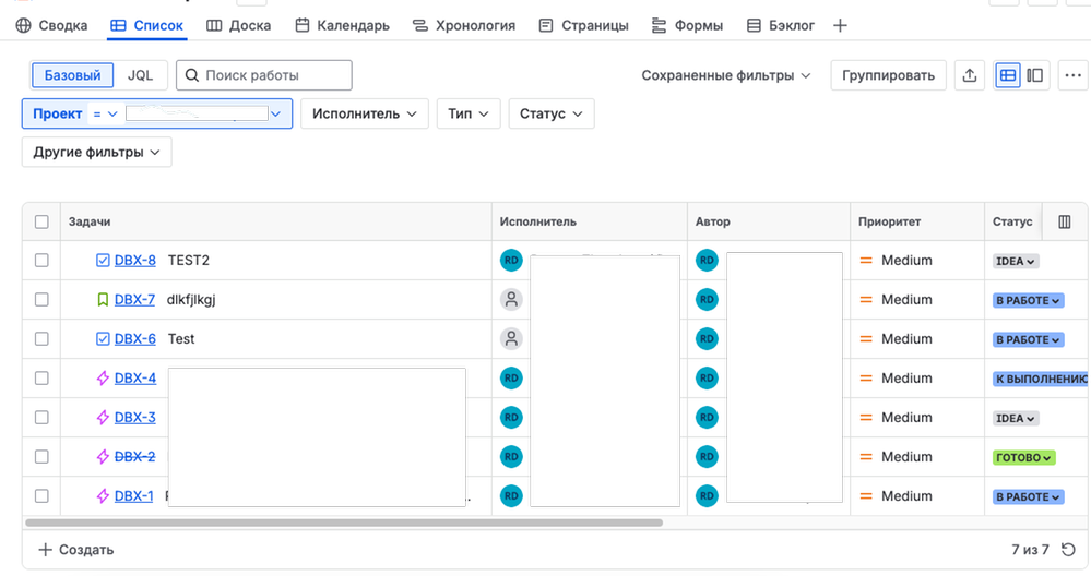

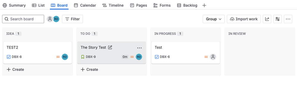

I created a new space and added some tasks from the List view, then switched to the Board view. Surprisingly, my tasks didn't appear there. Then I created a couple of tasks on the board, and now I see those two tasks in both views, but tasks created from the list still do not appear on the board. I have no filter applied by myself, and I do not see any other reason why tasks are hidden.
Could someone give any advice on how to solve this?

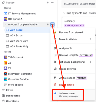

What kind of Space did you create? Get that information by clicking on the ... next to the Space name. the information is at the bottom of the pop-up.

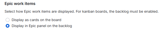

It may be due to the board filter, your work items DBX-1 to DBX-4 are all epics and DBX-7 is a story, whereas the two items that do appear on your board are both tasks.
Check that you board filter isn't set up to only show tasks.

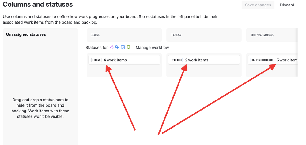

Your board may also be set up so that epics don't appear on the board:
(Found under board settings -> layout -> columns)

Hi @Stephen_Lugton
Not necessarily, List and board are interconnected between each other and it wouldn't make much sense to see it on the list but not on the board. This could be the case if the project was created with scrum template.

@Nikola Perisic that makes sense, my comment was based on only tasks being displayed not stories, especially when the statuses of one that isn't visible is the same as one that is, otherwise I would have also suggested checking the column mapping.
