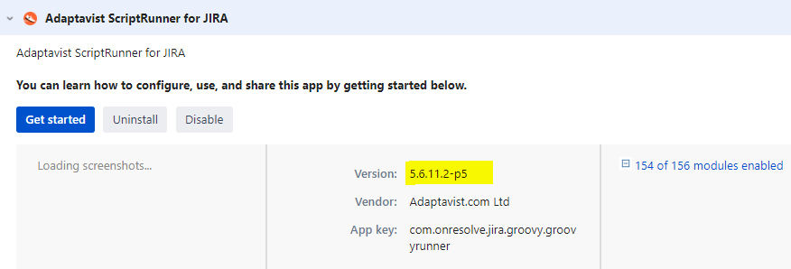

I think I am hitting a similar issue, but I still don't know how to fix it. The version is 5.6.11.2-p5 as shown below.
Current SR version in our JIRA PROD is v5.4.12, where I don't see the issue (but I haven't import my data yet).

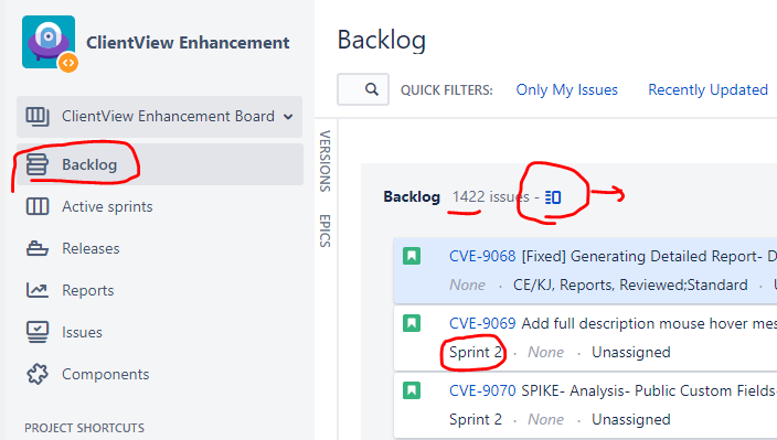

See the attached screenshot. I simply access the Backlog from the menu left. The query was showing when I click the icon looks like a CPU. I was assuming the backlog is generated by a fix query in JIRA, but seems like the query is generated by looking at issues in Backlog (the other way round)?

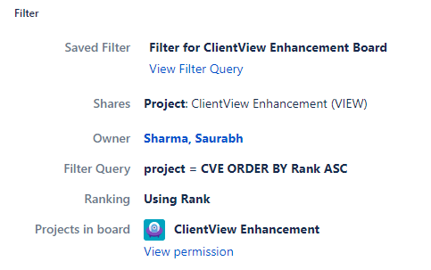

Can you try going to "board configuration" to see what we're really looking at? Should be some ellipses (...) near the top right
Is this what you are looking for? The filter query is project = CVE ORDER BY Rank ASC
I mean I didn't create that complex query. That query shows when I click the "CPU like" icon.

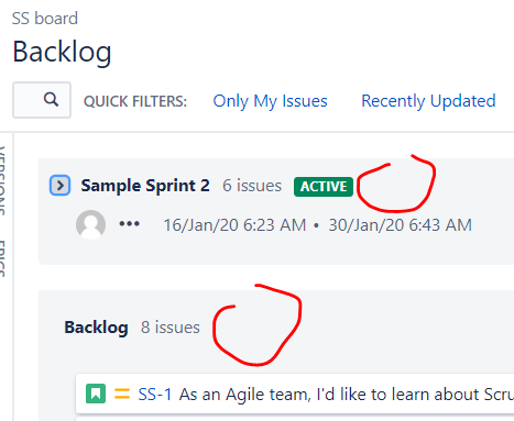

See my 1st screenshot, the 2nd issue is belong to "Sprint 2", but it's still in backlog? So now the question is back to how this backlog query is generated?

I spin up a new JIRA trial, you are right, base JIRA doesn’t have this icon. I think it’s from plugin “Adaptavist ScriptRunner for JIRA”. Let me contact my JIRA admin and find out
Ah, that has just kicked me in the memory! Thank you so much.
It absolutely is coming from ScriptRunner. It is there to try to give you the option to see the sprint, or backlog, that is currently in front of you.

I think the second thing I've missed is the Sprint field. If an issue is in a sprint, it will be grouped within that sprint, and will not be in the backlog section as shown in your screenshot. There are two ways to get a display like what you have there and you may be suffering one or both!
First, you have "backlog" named (with 1442, then the ScriptRunner icon) on the top line. Whilst this looks like a backlog, you might get that display if you have a sprint named "Backlog". I do not know if you have done that, but if you have, please don't. "Holding sprints" break all sorts of things.
Second, if you look at the second line in the display of the three issues, they start with none/sprint 2/sprint 2. This does not look like the Sprint, it looks like a (probably custom) field that holds some options (obviously, one of which is "Sprint 2"). But not the actual Sprint field. This makes me think that when we go back to your original question, there's a problem. You say "cf[10004] is Sprint" which is accurate, but also misleading (by Jira, not you!). It would be better to say "cf[10004] is a field called Sprint which is just a text or select field, not the actual Sprint"

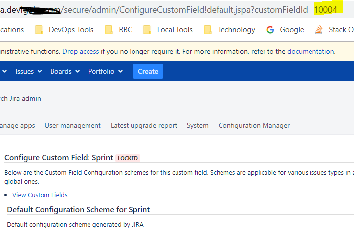

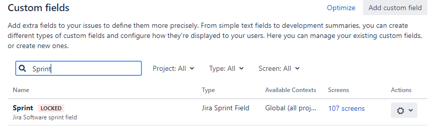

Can you go to Admin -> Issues -> Custom Fields and use ctrl-f to look for "Sprint". How many hits do you get? (I'm looking for an answer of "3", but it might be translated - the more complete search is that I am looking to check that you have one, single, field called "Sprint", which is "locked", has a type of "Jira Sprint Field" and a description of "Jira Software sprint field".

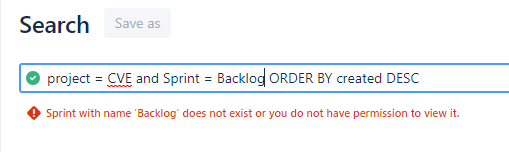

Can you go to Issues -> Search, and run the advanced search of "Sprint = Backlog"? Do you get any results, or an error?
Hi Nic
Thank you so much for your input. Unfortunately the answer to all your questions are no.
1. There is no Sprint called Backlog.
2. There is only 1 Sprint in the custom field, and the id is 10004.
3. There is no issue with "Sprint = Backlog"

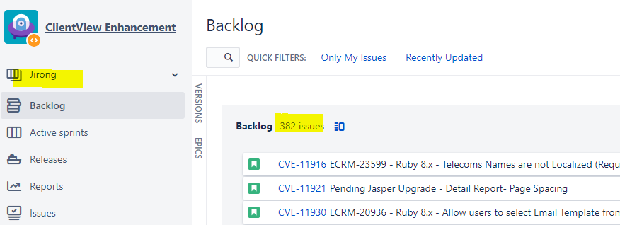

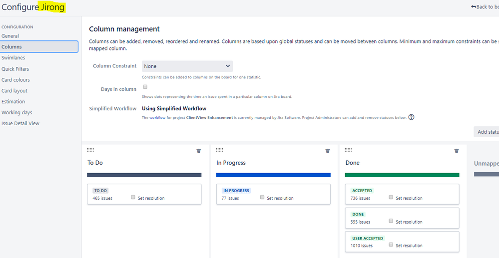

Please note: now when I create a new board "Jirong", the Backlog shows right. The query shows:
project = CVE AND status in ("10100", "3", "11600", "10002", "11603") AND (cf[10004] is EMPTY OR cf[10004] not in openSprints()) AND issuetype in standardIssueTypes() AND issuetype != "10000" AND NOT status in ("11600", "10002", "11603") ORDER BY Rank ASCCompare to the query in the bad board, the difference is later added two more status, and If I use this new query to replace the one in the bad board, the result is the same. So the question is still: how this query is generated?

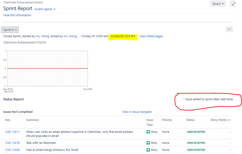

Another issue I found is the Sprint Report doesn't shows a chart, not sure if it's related. It's even the same in the newly created board "Jirong". Also I couldn't change the Sprint Complete Date. This is how I migrate these issues from Rally.
1. Create all Sprints (maps to Iterations in Rally) with startDate, endDate.
2. Import all issues from Rally, map the Iteration Names to Sprint IDs.
3. Use a loop to Start and Complete all Sprints, using REST API. Because of this, the Sprint Complete Date shows the date I run the REST API. I tried to update it through REST API but doesn't work. That's why in the chart, the end date is this month.
4. Note that "Issue added to sprint after start time".

All right, I think the Sprint Report is right, since I added all issues in the same day so the chart can't show anything useful.

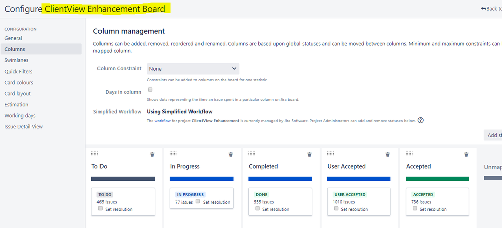

Finally I found the difference of the old board (wrong) and new board (right): the columns are difference, therefore the generated queries are different (in the status).

I notice if I move the columns around in the board, the query for the Backlog changes. Just don't know how it works.
