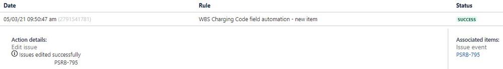

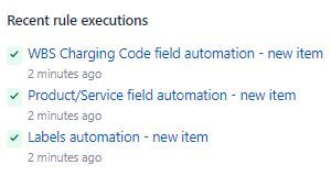

Hello,
I have a simple rules to populate some of the fields when new item (task, story) is created.
It was working fine at first but now nothing happens.
In rule execution everything looks fine:
When I check logs it's ok:
In a task these fields remain empty. I'm working on next-gen project.

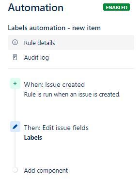

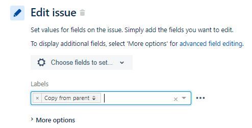

Katarzyna Michalik
March 8, 2021
I have 3 rules which are constructed in the same way but for different fields.
I received notification from which I understood that my rule was working but then was overwritten?
Is it possible that having 3 similar rules can somehow interfere?
Bill Sheboy
March 8, 2021
Hi @Katarzyna Michalik
When you have rules which could trigger each other, that can cause side-effects. If you have similar rules, perhaps not, unless the rules are acting on the same issues (e.g. task, story) and editing the same fields.  Then the changes from one rule could replace the others.
I am curious: if you have 3 rules trigged by the same condition (issue created) to edit different fields, why not use one rule to edit all of the fields?
For your current rule, please consider adding at log statement after the trigger to record the {{issue.parent}}  Perhaps the task doesn't have a parent.

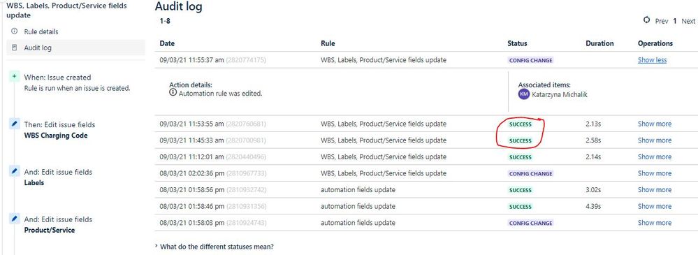

Katarzyna Michalik
March 9, 2021
Hello @Bill Sheboy
Unfortunately, this new rule just stopped working. Everything is exactly like before. In task and audit log rules are marked as success but fields in the task are empty.
I don't understand why it works at first and then it breaks down.
