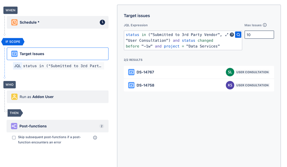

Yeah, the different statements was me being unclear, sorry.  It's running on the schedule I have it set to, but it's triggering on all cases in the statuses I set it for, not just the one that has been in this status for more than a week.
Testing it through the filters brought up the appropriate cases at the time, but we ran into an issue where it kept running on one specific case, even after the status changing should have stopped it from running.

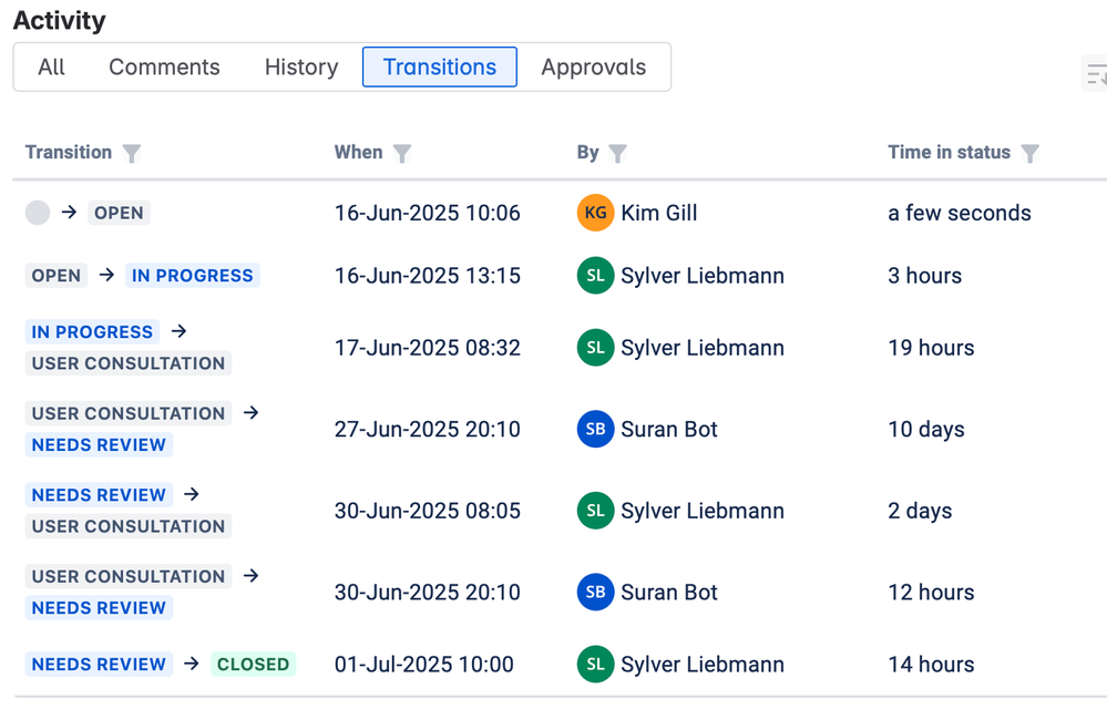

Regarding the issue it was operated on, I don't believe I have access to any sort of Transition history, unless I'm looking in the wrong spot.  I can see where the automation ran the day after the status was changed out of and then back to the target status, but that's it.
Like # people like this
Elsie Carroll
July 1, 2025
@Trudy P Claspill  I was looking in the wrong spot for transition history, I'm very sorry.  It's been a long day.Screenshot 2025-07-01 at 2.18.22 PM.png

I just realized I forgot to clarify that this is using JMWE, not the built in Jira automations, which is likely why this looks different.  It's still using JQL, though.  Under the apps section of Jira admin settings, JMWE has a link for event-based actions and a link for scheduled actions, and this is a scheduled action.
This is for a service management project/Ops category.

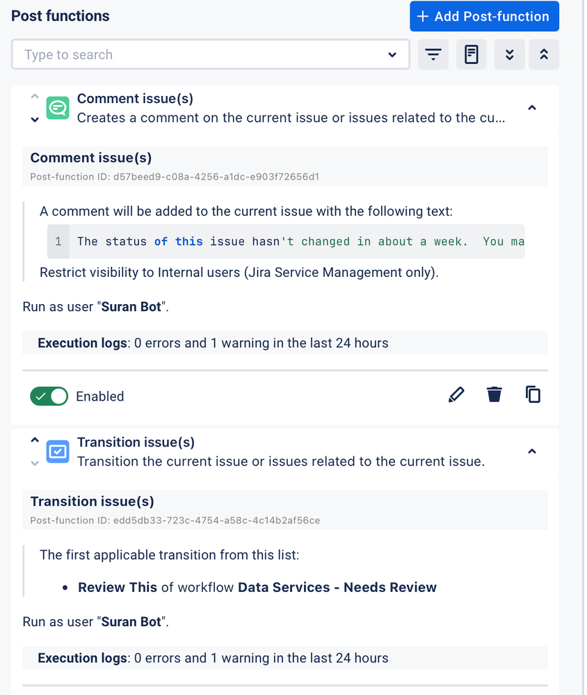

The very short version of the functions is: leave a comment on the work item, then transition the work item.Screenshot 2025-07-01 at 3.13.05 PM.png
