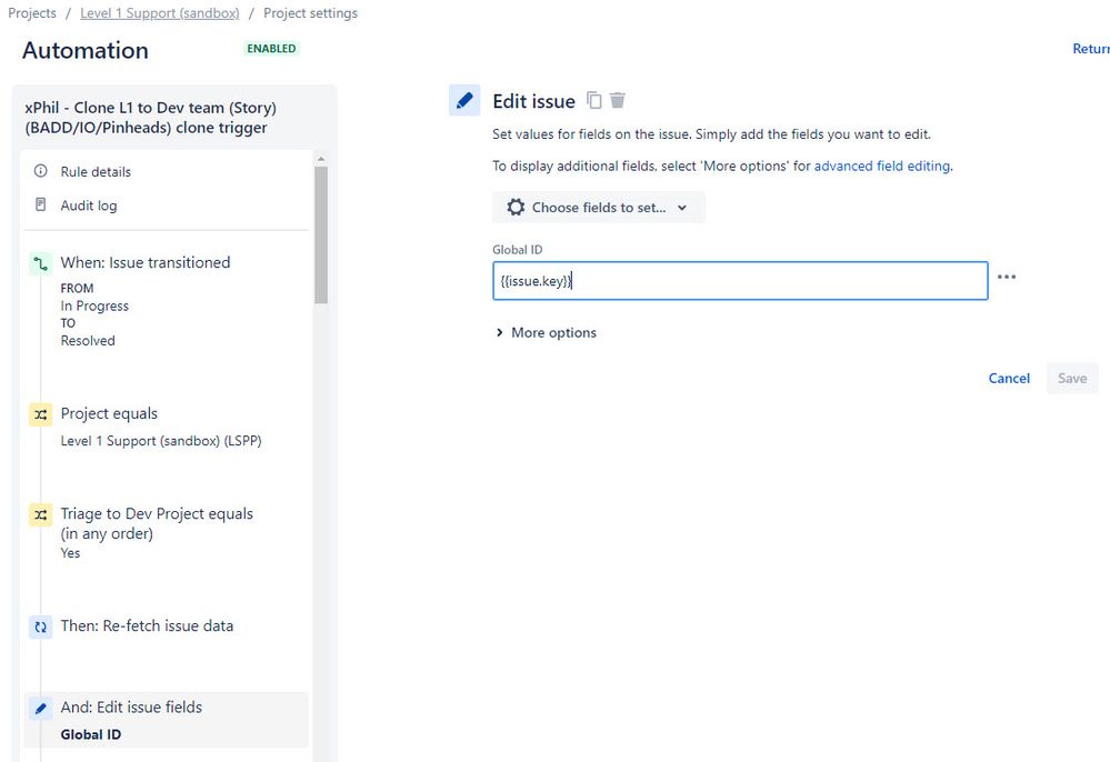

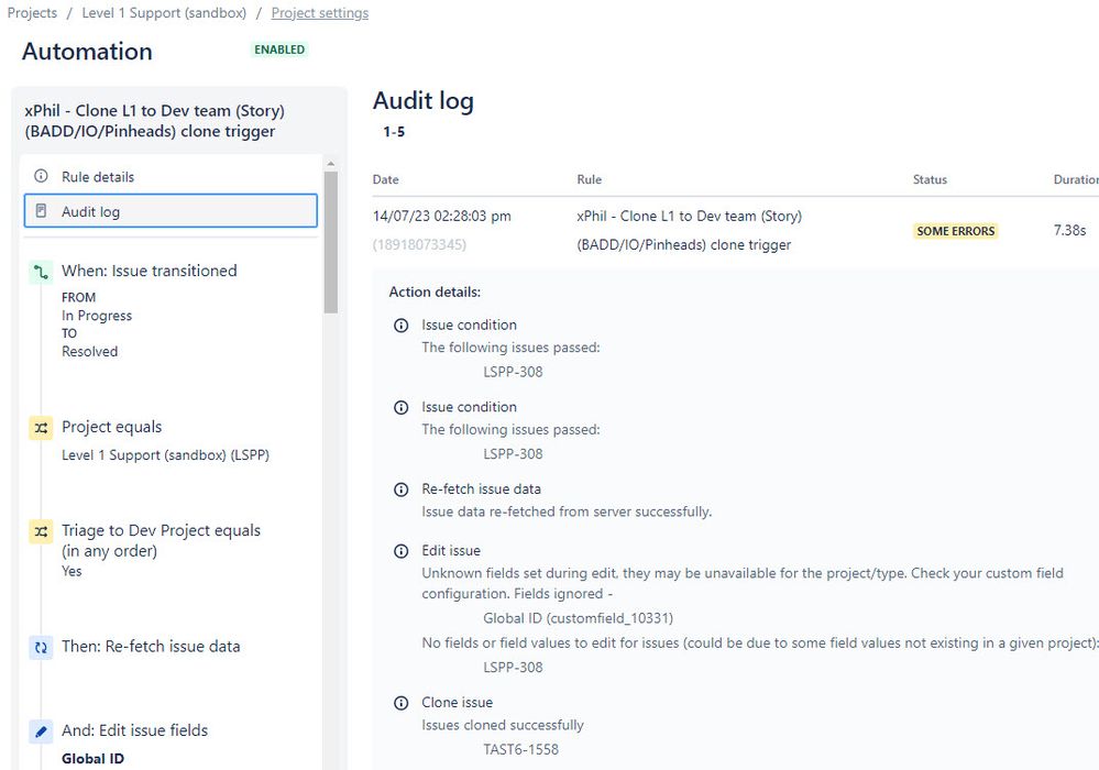

In an automation, I can't edit a custom field.
Beginning of automation and log
Automation edit action

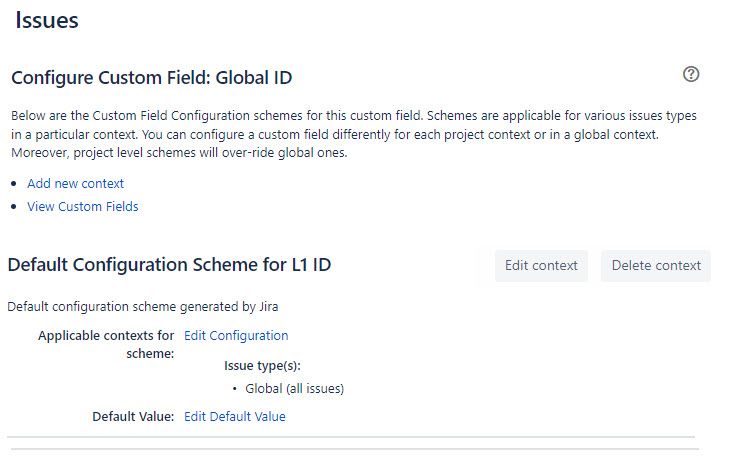

Custom field context

Also, I modified the trigger action (and edited the post with updated screen shots showing the new automation version), because although the automation worked once, with the trigger based on a field change, it has not worked in subsequent tests.  Now it's working again with the trigger based on a status change, followed by the condition in both versions, that the field value = yes.

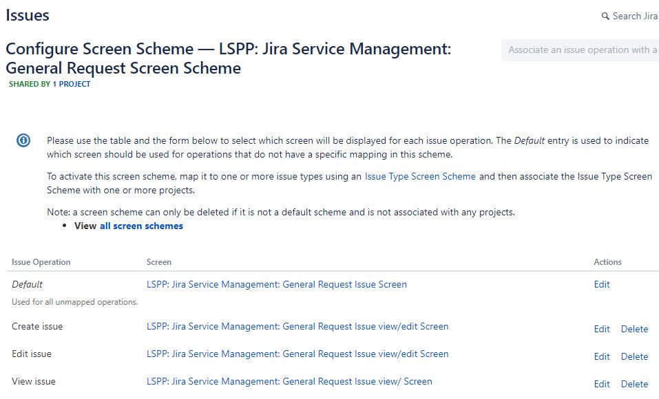

Below is the screen scheme for the Sandox Level 1 issue type that is in question.  All 4 screens listed contain Global Id in the Default tab.
Issue type screen scheme

Log actions confirm that Global Id is empty after the attempt to edit it in the parent, and after the clone edit action in the child (of course, since it's empty in the parent)
