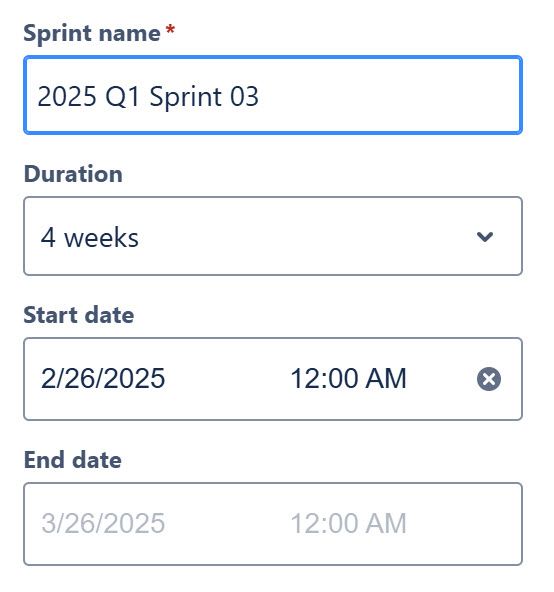

I'm using Jira Software Cloud, and I've got an automation to set the Due Dates of each issue relative to the Sprint's End Date. For example, Dev tasks need to be completed 5 business days before the end of the sprint. Because the Sprint's End Date is stored in UTC, I keep getting a date that is one day ahead. I have tried to convert to my time zone (US/Eastern), but it doesn't seem to be working? Just to test it, I set up an automation that only writes to the Audit Log.
Here is my Sprint information: jira-sprint-info-2025-02-26_20-46-45.jpg
The end date is actually 3/25, but I assumed once I converted "3/26/2025 12:00 AM" from UTC to US/Eastern, it would be 3/25.

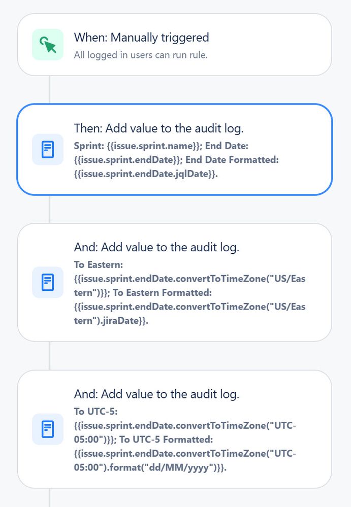

This is what I'm logging in the automation: jira-log-time-zones-2025-02-26_21-11-03.jpg

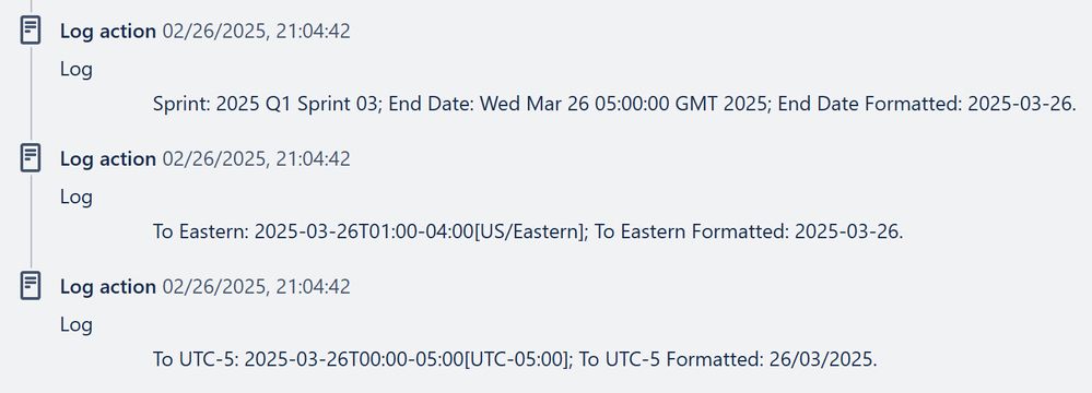

And these are the results in the Audit Log:
Why are the converted dates still 3/26 and not 3/25? What am I missing?

As a workaround, I'm now using:
{{issue.sprint.endDate.convertToTimeZone("UTC-06:00").jqlDate}}
And to get the Developer Due Date:
{{issue.sprint.endDate.convertToTimeZone("UTC-06:00").minusBusinessDays(5).jqlDate}}
But I'd still like to understand why converting to my time zone didn't work?

Okay, so after WAY too much time and frustration, I answered my own question. I'll share here so maybe I can help someone else.
When I viewed the sprint information: jira-sprint-info-2025-02-26_20-46-45.jpg
The "End date" of 3/26/2025 12:00 AM is already converted to US/Eastern because that is the time zone I have set in my profile. But the date that is actually stored as: "Wed Mar 26 05:00:00 GMT 2025", which is what I saw when I logged sprint.endDate.
IMNSHO, Jira should not have made "3/26/2025 12:00 AM" the End date when we selected a 4 week sprint - it should have been "3/25/2025 11:59 PM", which would have solved some of my problems.
There are several ways to work around both the time zone conversion and the end date being at midnight. What I ended up choosing is:
{{triggerIssue.sprint.endDate.minusHours(6).jqlDate}}
By subtracting 6 hours, I compensate for the 5 time zone difference AND the midnight setting. And if someone changes the sprint end date to something more logical, like "3/25/20256 11:30 PM", it will not negatively impact that calculation. And using jqlDate strips off the time part, which I don't need anyway.
