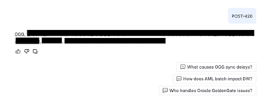

However, I'm seeing a difference in the response when I give the prompt TEST-111 to the agent through Jira Automation versus when I give the same prompt in the Rovo agent's chat interface.
  • In Jira Automation, the agent returns N/A, as if it can't find the information.
  • In the Rovo Chat, the agent correctly returns the keywords as A,B,C.

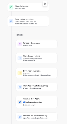

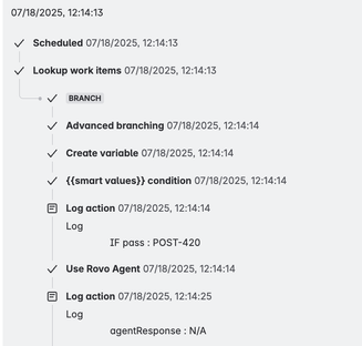

엄성렬
July 17, 2025
Hi @Bill Sheboy
Here is my rule and audit log and chat.
I hope this provides the clarity needed to diagnose the symptom. Please let me know if you need any other details from my end. Thanks again for your help!

Bill Sheboy
July 18, 2025
Thanks for that information.
I have seen questions with timing problems with Rovo agents where first storing the {{agentResponse}} in a created variable allowed better access, although I would not expect that to be a problem when logging the value.
