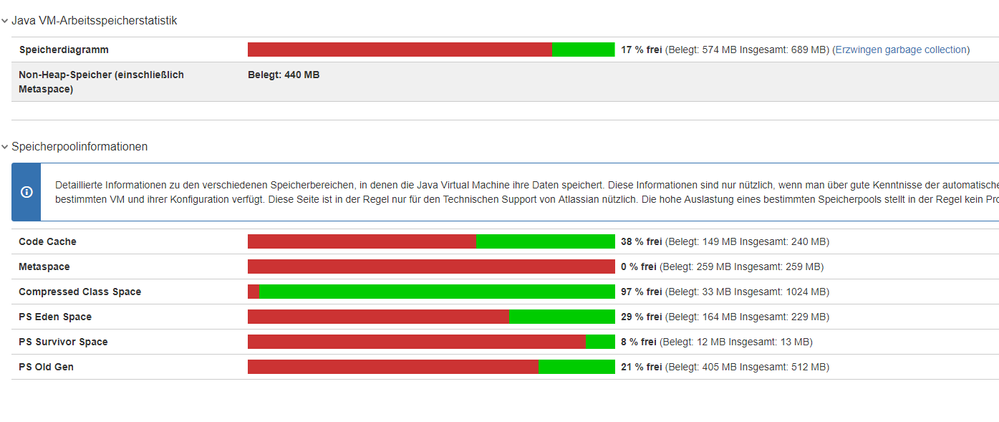

The version of Jira is 7.7.0. Following you can see the actual storage overview.Unbenannt.PNG
The jira is configured with ssl.
BR, Thomas
