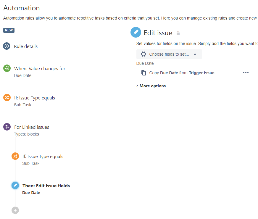

Based on what you have provided, the rule is triggered when the Due Date is changed on Task A. You will need a step in the rule to change the focus to the blocked Task (Task B) in order to edit that task.
As you have shown it, the Edit operation would be editing the same issue that triggered the rule.

This is an example from Data Center v9.10.x

There are no additional steps beyond what is in the image - nothing at the bottom of the branch.

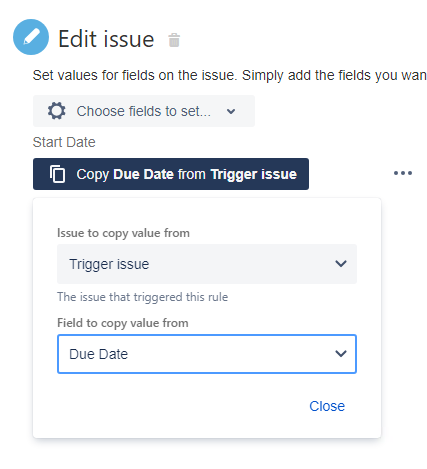

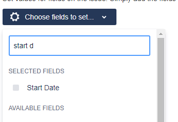

To shift the start of the blocked task (Task B) to be the new Due Date of the blocking task (Task A) you would set the Edit action to update the Start Date field by copying the Due Date field from the trigger issue. This is the same, basically, as what I showed in the image, but you need to pick the Start Date field.

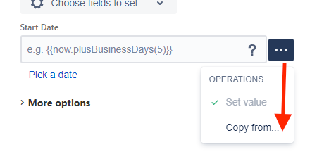

After selecting the field, click on the ... button and choose Copy from

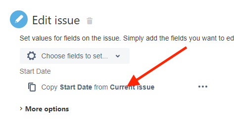

That will change the input field to look like this.

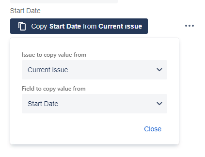

Click somewhere in that text and that will open a pop-up like this.
In this pop-up you can change the Issue to copy value from field to Trigger Issue, and change the Field to copy value from to Due Date. Then click the Close button in the bottom right corner of the pop-up.
