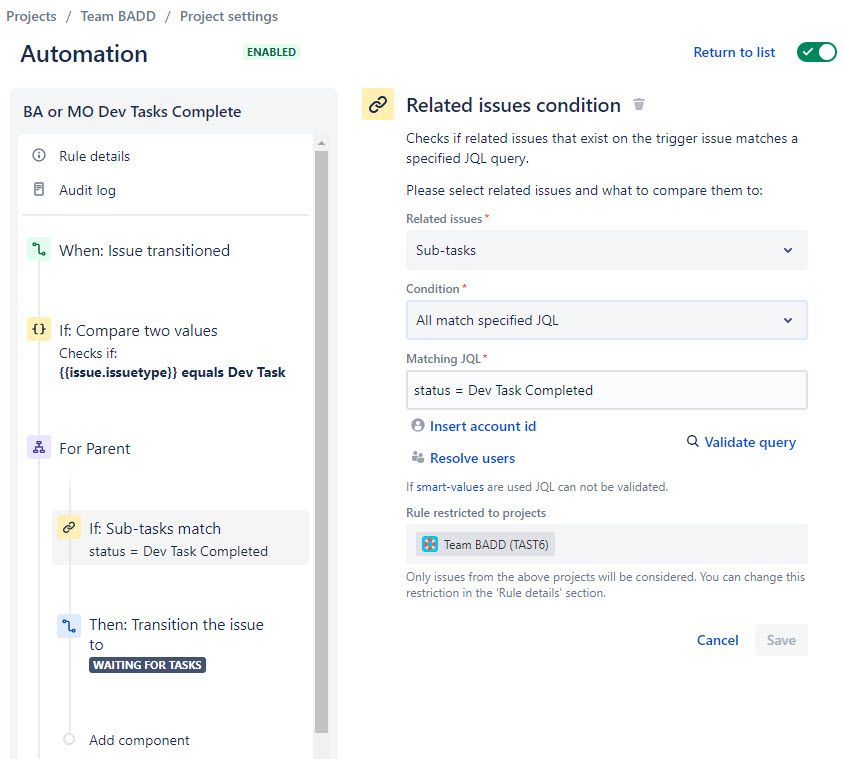

In the sandbox, I have a working automation that creates one or more sub-tasks (Issue Type = Dev Task) when a particular transition is run.

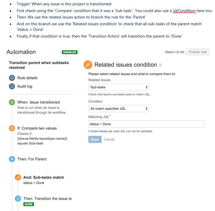

I modeled the automation after one I found in:
https://community.atlassian.com/t5/Automation-questions/How-can-I-transition-the-parent-when-all-subtasks-are-resolved/qaq-p/159407
The automation log shows NO ACTION PERFORMED when I complete the only sub-task I created.
I tried sub-task instead of Dev Task as the {{issue.issuetype}}, and {{issue.issuetype.name}} = Dev Task.  (I don't think I tried {{issue.issuetype.name}} = sub-task.)
Note in the screenshots below that my rule branch contains "If:", but the community post rule contains "And:".  How was "And:" obtained?
My rule
Rule from Community post

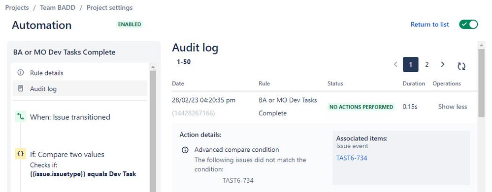

Bill Sheboy
February 28, 2023
Hi @Phil Bustin
Would you please post an image of the audit log details, showing the rule execution?  That may provide more context for this symptom.  Thanks!
Regarding your comment about the "And" in the old screen image (from that post), I believe that is just the evolving UX of the rule editor, over time, changing.
Kind regards,
Bill

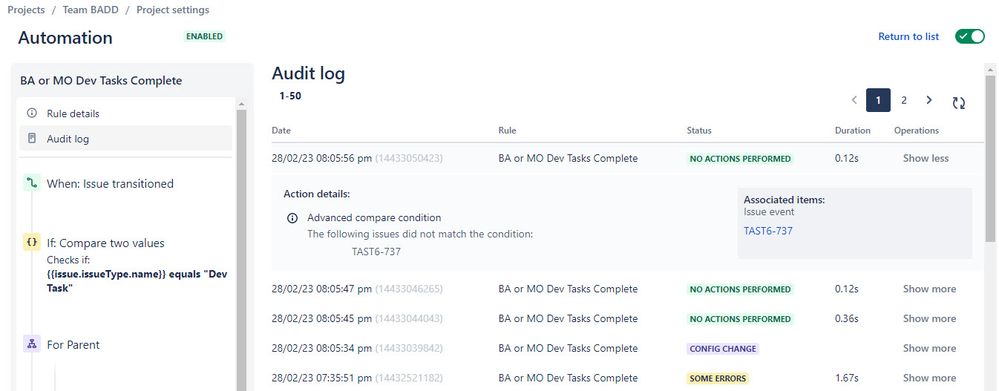

Phil Bustin
February 28, 2023
Bill Sheboy
February 28, 2023
Thanks for that information.
I think this is both a smart value name/case-sensitive and default attribute thing.  Please try changing your advanced compare condition to check this:
  • first value: {{issue.issueType.name}}
  • condition: equals
  • second value: Dev Task
And...if that does not help, try writing this to the audit log before the condition to confirm the case/spacing/name of the issue type:

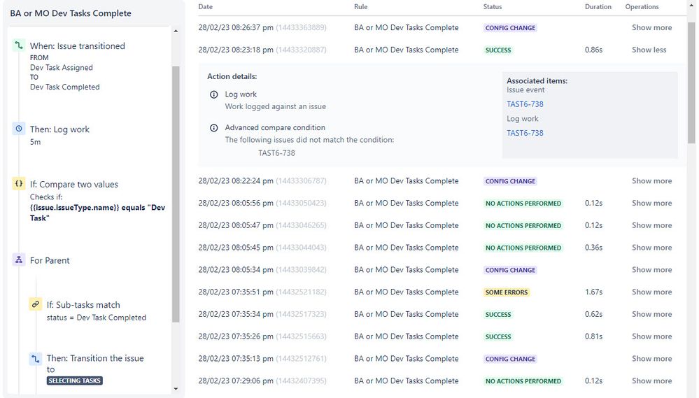

Phil Bustin
February 28, 2023
That didn't work; nor did it when I tried it before.  See screen shot below for confirmation.
I'm not aware of a way of writing to the audit log, but I tried adding it in a comment in a Log work action.  After that the automation showed success twice, although I wasn't aware of that at first, but then showed errors.  It did not transition the parent.  I'm not sure what the comment display signifies, although I think it shows that the issue type name syntax is correct.

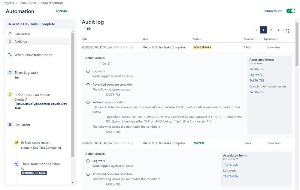

Bill Sheboy
February 28, 2023
I believe that error is from the status name not being wrapped in quotation marks in your related issues condition.  Please try this instead there:
status = "Dev Task Completed"
Phil Bustin
February 28, 2023
Thanks.  In the meantime, Is the method I used to write to the log what you had in mind?
Phil Bustin
February 28, 2023
No actions performed.  Also: Why are there 3 logs for this automation?  Is it because the first condition is an undefined When Issue is Transitioned?  And if so, why wouldn't I define the transition, since there can only be one?
Phil Bustin
February 28, 2023
Oops!  Success, plus I had the wrong status destination.  All is well.  Thank youRule success log.jpg
