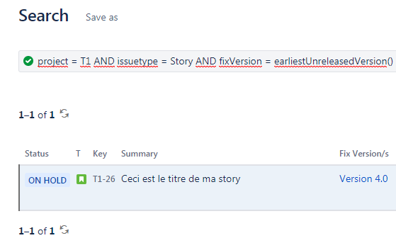

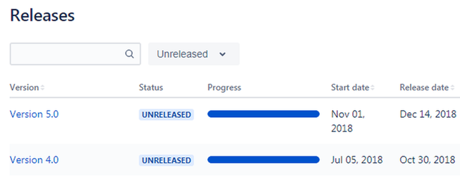

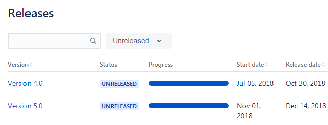

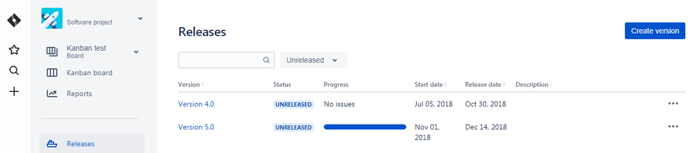

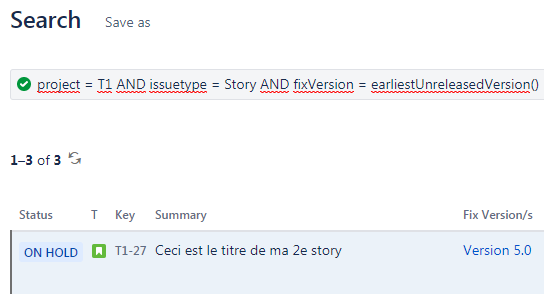

You can change that order in the Releases menu by drag-and-drop:
This screenshot is from a Cloud instance so it may looks different if you're on Server. Let me know if it works :)
I'm afraid it's not working with drag&drop.
I've just did that and still have same version for that query, even though it's on the bottom.
Hmm that's weird, it is working on my side:
