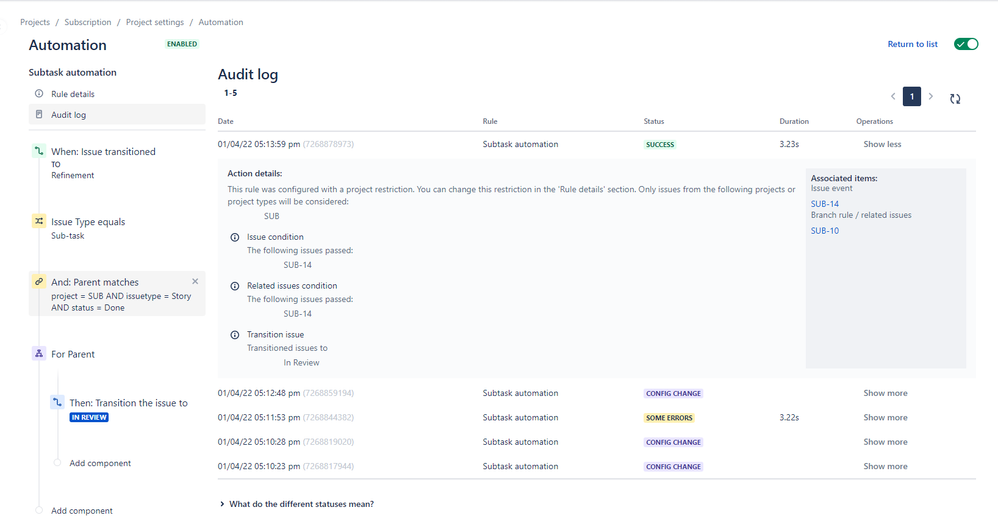

Hi Fernando, thank you for reaching out!  We are not quite aligned.  Here's hopefully a clearer version:
If a new sub-task is added even after Story has been completed, that same sub-task is automatically assigned a status of "TO DO" so I want my Story to go from DONE to IN PROGRESS.
Hopefully this makes sense.  Thanks again!

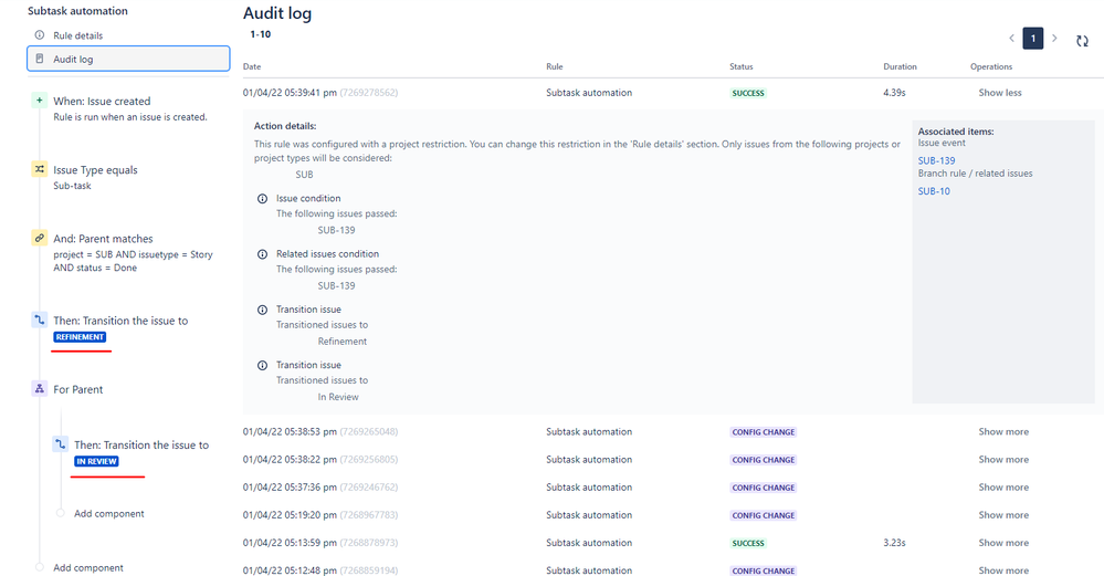

Fernando Eugênio da Silva
April 1, 2022

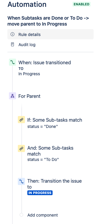

I think I understood and it became clearer. Just to ensure:
If a subtask is created even after the Story has been completed, then the subtask should automatically move to TO DO while the Story should automatically move from DONE to IN PROGRESS.
Here's a tweaked version of automation of how it might work for you.
Details:
- The second CONDITION of JQL you have to select this JQL inside the CONDITION "RELATED ISSUES CONDITION".
- Change statuses to the ones that make sense. Being the first ACTION on Subtask's "TO DO" status
- Create the BRANCH for "PARENT ISSUE" and the second ACTION is the Story transition.
Let me know if now that´s right for you.
Regards,
Fernando
Rich Evers
April 1, 2022
It worked!  Thanks Fernando!  Have a great weekend!
