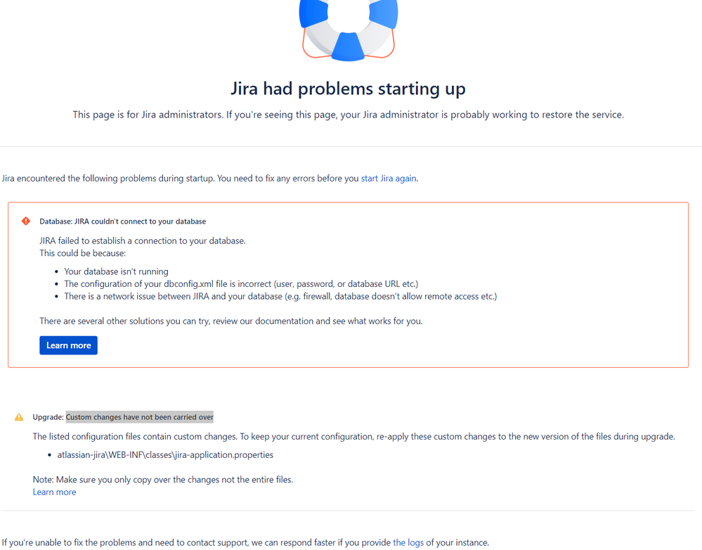

When I enter localhost:8090 in the browser, the following occurs截图1.png

March 10, 2022
It is exactly what it says it is - Jira cannot connect to the database you have told it to use.
The "learn more" it links to can be very useful, but this really does mean you should have a quick look at the log to see if it gives you a bit more information about the exact error (it might not tell you a lot more, depending on the problem), and then you'll need to revise the settings, your network, and check your database is running and configured correctly.
Click the "learn more" to avoid us having to copy and paste it all here for you to read and follow.
li si
March 10, 2022
I installed it on my native windows,
ping 127.0.0.1 also works
Do you need log, I see “learn more”, I have no problem

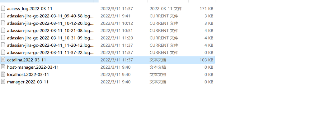

March 10, 2022
which log file

March 11, 2022
Sorry, I should have said - you need the application log file (the catalina logs are the application-server log files, which may also have errors when Jira is failing, but the error you are seeing is Jira failing, not Tomcat, so there's a 99.99% chance the useful log will be the application log)
The application logs are in <jira home>/logs and the very first one to read is atlassian-jira.log
For database errors like the one you have above, it's likely to say "can't use database", but it often tells you more about why it can't.  The usual culprits are
  • Can't connect to database server (database is not reachable over your network, or isn't running)
  • Can't log into database (usually the wrong credentials)
  • Can't use the database properly (usually the database user is set up incorrectly and can't write to it, or the collation or other settings are wrong)

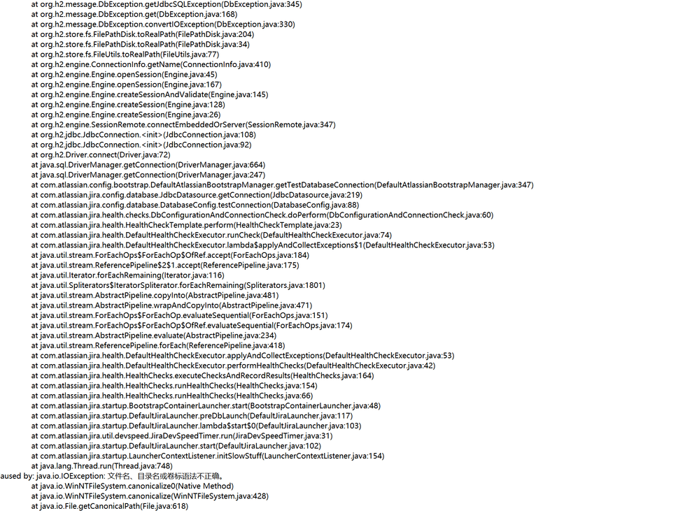

this is my full log:

2022-03-12 18:37:43,501 JIRA-Bootstrap ERROR [c.a.config.bootstrap.DefaultAtlassianBootstrapManager] Could not successfully test your database:
org.h2.jdbc.JdbcSQLException: IO Exception: "java.io.IOException: 文件名、目录名或卷标语法不正确。"; "retry:C:/Users/li si/Atlassian/Application Data/Jira/database/h2db.mv.db" [90031-185]
at org.h2.message.DbException.getJdbcSQLException(DbException.java:345)
at org.h2.message.DbException.get(DbException.java:168)
at org.h2.message.DbException.convertIOException(DbException.java:330)
at org.h2.store.fs.FilePathDisk.toRealPath(FilePathDisk.java:204)
at org.h2.store.fs.FilePathDisk.toRealPath(FilePathDisk.java:34)
at org.h2.store.fs.FileUtils.toRealPath(FileUtils.java:77)
at org.h2.engine.ConnectionInfo.getName(ConnectionInfo.java:410)
at org.h2.engine.Engine.openSession(Engine.java:45)
at org.h2.engine.Engine.openSession(Engine.java:167)
at org.h2.engine.Engine.createSessionAndValidate(Engine.java:145)
at org.h2.engine.Engine.createSession(Engine.java:128)
at org.h2.engine.Engine.createSession(Engine.java:26)
at org.h2.engine.SessionRemote.connectEmbeddedOrServer(SessionRemote.java:347)
at org.h2.jdbc.JdbcConnection.<init>(JdbcConnection.java:108)
at org.h2.jdbc.JdbcConnection.<init>(JdbcConnection.java:92)
at org.h2.Driver.connect(Driver.java:72)
at java.sql.DriverManager.getConnection(DriverManager.java:664)
at java.sql.DriverManager.getConnection(DriverManager.java:247)
at com.atlassian.config.bootstrap.DefaultAtlassianBootstrapManager.getTestDatabaseConnection(DefaultAtlassianBootstrapManager.java:347)
at com.atlassian.jira.config.database.JdbcDatasource.getConnection(JdbcDatasource.java:219)
at com.atlassian.jira.config.database.DatabaseConfig.testConnection(DatabaseConfig.java:88)
at com.atlassian.jira.health.checks.DbConfigurationAndConnectionCheck.doPerform(DbConfigurationAndConnectionCheck.java:60)
at com.atlassian.jira.health.HealthCheckTemplate.perform(HealthCheckTemplate.java:23)
at com.atlassian.jira.health.DefaultHealthCheckExecutor.runCheck(DefaultHealthCheckExecutor.java:74)
at com.atlassian.jira.health.DefaultHealthCheckExecutor.lambda$applyAndCollectExceptions$1(DefaultHealthCheckExecutor.java:53)
at java.util.stream.ForEachOps$ForEachOp$OfRef.accept(ForEachOps.java:184)
at java.util.stream.ReferencePipeline$2$1.accept(ReferencePipeline.java:175)
at java.util.Iterator.forEachRemaining(Iterator.java:116)
at java.util.Spliterators$IteratorSpliterator.forEachRemaining(Spliterators.java:1801)
at java.util.stream.AbstractPipeline.copyInto(AbstractPipeline.java:481)
at java.util.stream.AbstractPipeline.wrapAndCopyInto(AbstractPipeline.java:471)
at java.util.stream.ForEachOps$ForEachOp.evaluateSequential(ForEachOps.java:151)
at java.util.stream.ForEachOps$ForEachOp$OfRef.evaluateSequential(ForEachOps.java:174)
at java.util.stream.AbstractPipeline.evaluate(AbstractPipeline.java:234)
at java.util.stream.ReferencePipeline.forEach(ReferencePipeline.java:418)
at com.atlassian.jira.health.DefaultHealthCheckExecutor.applyAndCollectExceptions(DefaultHealthCheckExecutor.java:53)
at com.atlassian.jira.health.DefaultHealthCheckExecutor.performHealthChecks(DefaultHealthCheckExecutor.java:42)
at com.atlassian.jira.health.HealthChecks.executeChecksAndRecordResults(HealthChecks.java:164)
at com.atlassian.jira.health.HealthChecks.runHealthChecks(HealthChecks.java:154)
at com.atlassian.jira.health.HealthChecks.runHealthChecks(HealthChecks.java:66)
at com.atlassian.jira.startup.BootstrapContainerLauncher.start(BootstrapContainerLauncher.java:48)
at com.atlassian.jira.startup.DefaultJiraLauncher.preDbLaunch(DefaultJiraLauncher.java:117)
at com.atlassian.jira.startup.DefaultJiraLauncher.lambda$start$0(DefaultJiraLauncher.java:103)
at com.atlassian.jira.util.devspeed.JiraDevSpeedTimer.run(JiraDevSpeedTimer.java:31)
at com.atlassian.jira.startup.DefaultJiraLauncher.start(DefaultJiraLauncher.java:102)
at com.atlassian.jira.startup.LauncherContextListener.initSlowStuff(LauncherContextListener.java:154)
at java.lang.Thread.run(Thread.java:748)
Caused by: java.io.IOException: 文件名、目录名或卷标语法不正确。
at java.io.WinNTFileSystem.canonicalize0(Native Method)
at java.io.WinNTFileSystem.canonicalize(WinNTFileSystem.java:428)
at java.io.File.getCanonicalPath(File.java:618)
at org.h2.store.fs.FilePathDisk.toRealPath(FilePathDisk.java:201)
... 43 more
2022-03-12 18:37:43,507 JIRA-Bootstrap ERROR [c.a.jira.health.HealthChecks] JIRA couldn't connect to your database
2022-03-12 18:37:43,507 JIRA-Bootstrap ERROR [c.a.jira.health.HealthChecks] JIRA failed to establish a connection to your database.
This could be because:
- Your database isn't running
- The configuration of your dbconfig.xml file is incorrect (user, password, or database URL etc.)
- There is a network issue between JIRA and your database (e.g. firewall, database doesn't allow remote access etc.)
There are several other solutions you can try, review our documentation and see what works for you.
2022-03-12 18:37:43,512 JIRA-Bootstrap INFO [c.a.jira.startup.JiraStartupLogger] Running JIRA startup checks.
2022-03-12 18:37:43,512 JIRA-Bootstrap FATAL [c.a.jira.startup.JiraStartupLogger] Startup check failed. JIRA will be locked.
2022-03-12 18:37:43,636 JIRA-Bootstrap INFO [c.a.jira.startup.LauncherContextListener] Memory Usage:
Heap memory : Used: 116 MiB. Committed: 417 MiB. Max: 2031 MiB
Non-heap memory : Used: 40 MiB. Committed: 64 MiB. Max: 1536 MiB
TOTAL : Used: 156 MiB. Committed: 481 MiB. Max: 3567 MiB
Nic Brough -Adaptavist-
March 12, 2022
You need to find the part of it where it says it can't connect to the database.
li si
March 12, 2022
... 43 more
March 12, 2022
Sorry, my last comment crossed over with your posting of the log you actually needed to show us.
So, yes, that's pretty clear.  Your Jira is configured to use the dev/test h2 database rather than a proper one for any serious use.
h2 is a file based database, and Jira reads the files from it as it starts up.  For some reason, it is unable to read the database files, so it cannot start up properly.
You'll need to check that the database files are there and have the right permissions for the Jira user to read and write it, but I'm afraid the most likely problem is that the files are damaged.
If the permissions on the database files are ok, then it's likely that you've had a massive failure and your only option is to restore from the last backup.
h2 is only used for dev/test activity because it can fail without warning, especially when under heavier usage.  When it fails, it's usually catastrophic, not a couple of corrupt lines, but a complete loss of everything.
If you do have to restore from a backup, your next task should be to drop everything else and migrate to a supported database.

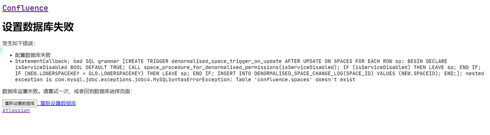

The database file is the one given in the error message (with h2db in its name)
The SQL error you are getting is there because your database is corrupt

You can talk about how to solve this problem of jira, confluence and jira are independent, both of them have problems, the screenshot I gave you above is from confluence
March 12, 2022
Ah, ok, I see that now, but I don't understand why you've suddenly changed the subject from one system to another.
It does not help that the error you are seeing in Confluence can be caused by the same problem you have with your Jira - I have conflated the two together because both problems you are talking about now could easily be caused by the same thing - a corrupted (h2) database.

jira's problem is solvd , i want to ask conflence,please see it
StatementCallback; bad SQL grammar
[CREATE TRIGGER denormalised_space_trigger_on_update AFTER UPDATE ON SPACES FOR EACH ROW sp: BEGIN DECLARE isServiceDisabled BOOL DEFAULT TRUE; CALL space_procedure_for_denormalised_permissions(isServiceDisabled); IF (isServiceDisabled) THEN LEAVE sp; END IF; IF (NEW.LOWERSPACEKEY = OLD.LOWERSPACEKEY) THEN LEAVE sp; END IF; INSERT INTO DENORMALISED_SPACE_CHANGE_LOG(SPACE_ID) VALUES (NEW.SPACEID); END;];
nested exception is com.mysql.jdbc.exceptions.jdbc4.MySQLSyntaxErrorException: Table 'confluence.spaces' doesn't exist
March 18, 2022
This also looks like a damaged database, or possibly a mis-configured one.  I'd want to run throug the same debugging you did for Jira.
