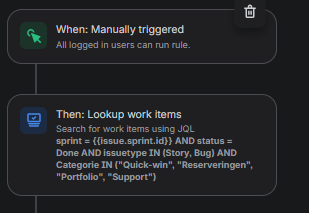

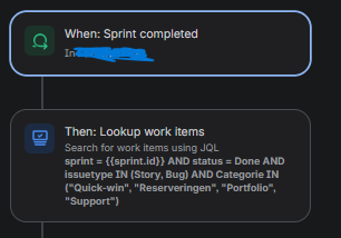

While in the process of building an automation that should do something with issues on sprint complete, I used a manual trigger to test the rule so I don't constantly have to make/reopen dummy sprints. When I was done I switched the trigger to on sprint complete and tested it. To my surprise the {{lookupIssues}} now behaved different:
I ask a rovo agent to go through the attachments in {{lookupIssues}} and write down the filenames in a specific format(along with generated texts which is used later in a web request). This works fine when doing it the manual trigger way. However, when I switched to the on sprint complete trigger, the rovo agent couldn't see the attachments in {{lookupIssues}}. I find this very weird and don't understand what the difference is.
If I log the {{lookupIssues.first.attachments}} I can see the attachmentbeans in both versions. I know that when referring to {{lookupIssues}} in bulk, one cannot see the full attachment beans but a reduced version which contains at least the filenames. I built my whole automation on the assumption that lookup work items works the same in both cases and now I probably have to rethink and rewrite a lot which is very frustrating.

Back to your rule, there are two possible causes for the symptom you observed:
(a) The {{issue.sprint}} smart value is a list, and thus the JQL expression sprint = {{issue.sprint.id}} could be comparing a field to a list-as-an-array, causing unexpected results.
(b) Some smart values are only loaded just-in-time when used, potentially leading to race-track timing problems in some rule actions.  I have observed this with the attachments, subtasks, and issuelinks smart values.  Depending upon the rule scenario, a couple of workarounds are to first capture the data in created variables (forcing full evaluation) or to use the long-format iterators to give logic time to load the information.

This difference is expected and comes down to how automation context is built for different triggers.
When you use a Manual trigger, Jira executes the rule in a full issue context, so {{lookupIssues}} contains richer data and downstream actions (like Rovo agents) can access attachment metadata as expected.
When the trigger is Sprint completed, the rule runs in a sprint-level context, not an issue-level one. In this context:
{{lookupIssues}} still returns issues
Attachments are available only as limited beans
Actions that require full attachment context (like Rovo agents reading filenames/content) may not be able to access them
That’s why:
Logging {{lookupIssues.first.attachments}} works (basic data exists)
But the Rovo agent cannot “see” or process the attachments
Workarounds
Add a branch: For each issue in lookupIssues and run the Rovo agent inside that branch (this restores issue-level context)
Or trigger a secondary rule (issue-based) from the sprint rule and do the attachment processing there
Avoid relying on bulk {{lookupIssues}} attachment access when using sprint-based triggers

I wonder why they made it this way, isn't it reasonable to think that on complete sprint trigger sometimes also needs all the issue information/context? Im doing it to generate release notes and it needs to run when a team closes a sprint.
Anyway I found a workaround myself: I created a variable with this smartvalue :
"{{#lookupIssues}}
Issue: {{key}}
Summary: {{summary}}
Attachments: {{attachments}}
and then passed the variable in the rovo prompt.
Thanks anyway!
