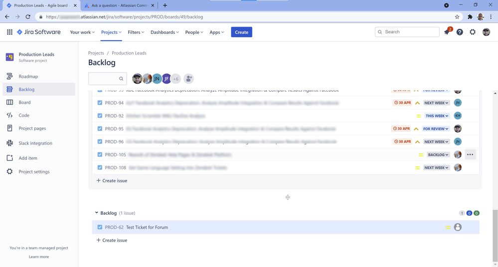

1. When I create a ticket, it doesn't show up in the Backlog column on my board. Rather, it shows up in the "Backlog" of the Backlog tab. This is an unnecessary and annoying step that I'd like to eliminate
2. To get the new ticket onto my board in the Backlog column, I have to drag the ticket from the Backlog section in the screenshot above to  the Board section above.

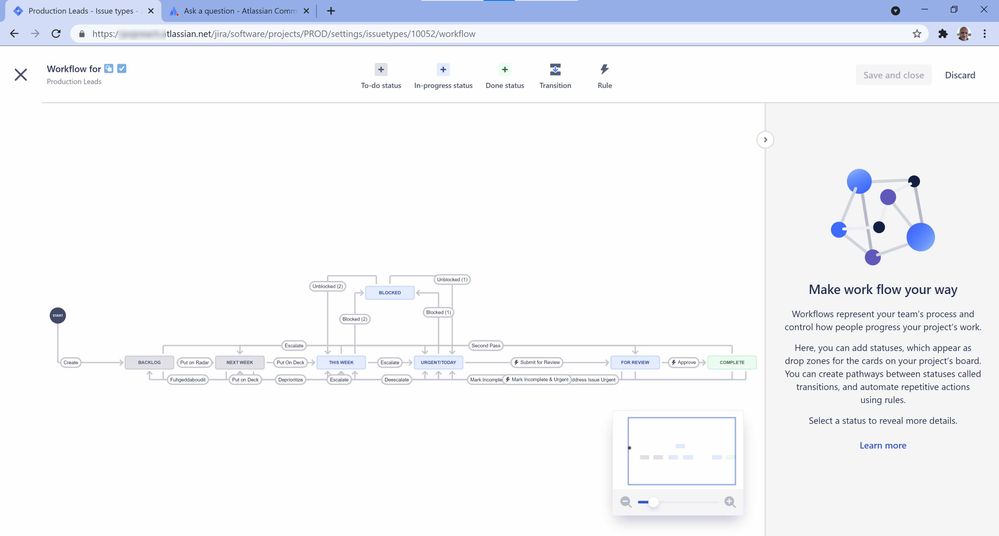

3. My workflow is setup as shown in the screenshot below, the desired behaviour is for the newly created ticket to show up immediately on my board in the backlog column I have on my board. I want to eliminate the step of moving the ticket in the backlog tab described above.

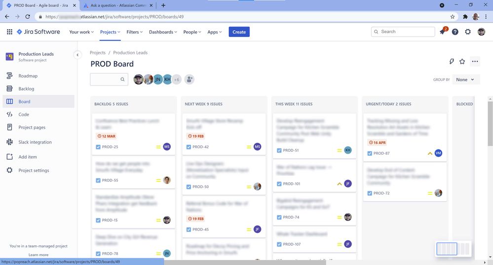

4. For reference, this is what my board looks like...
