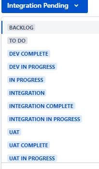

I recently created 3 new statuses and mapped them to a workflow. Each status has also been mapped to a column within my Kanban board. Although everything appears to be mapped, transitioned, and published properly, I am still unable to see the statuses in the drop down of an issue screen.
Can someone shed some light as to what I could be missing?

Im not sure I follow... as we use the standard issue types, such as Epics, Story, Subtasks, Bugs, and defects. For any of these issue types, we may associate them with different status (such as To Do, Dev In Progress, Integration In progress, Done). I am trying to add additional statuses , for example Cancelled, On Hold or Analyze , to this project... but they are not appearing in the list box of an issue

If you have already added the statuses to the workflow, did you Publish the workflow? A lot of people miss that step.
Dan Pastore
May 24, 2022
I confirmed my changes were published

Thanks, Dan...and my bad: the project can see these new status values if you were able to map them to the board.
I just looked in the public backlog and didn't see this symptom.  The only other things I can think are to re-check if there is a transition problem in the workflow, or even some data caching issue in the browser (although that would be weird for status).
Like John Funk likes this
John Funk
May 24, 2022
Another thing to check is the transitions to those statuses to see if they are available from the current status of the issue and that there are not any conditions that might be preventing them from showing up.
