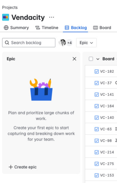

Why can't I see epics in the epic panel
Yme van der Linden
April 14, 2025

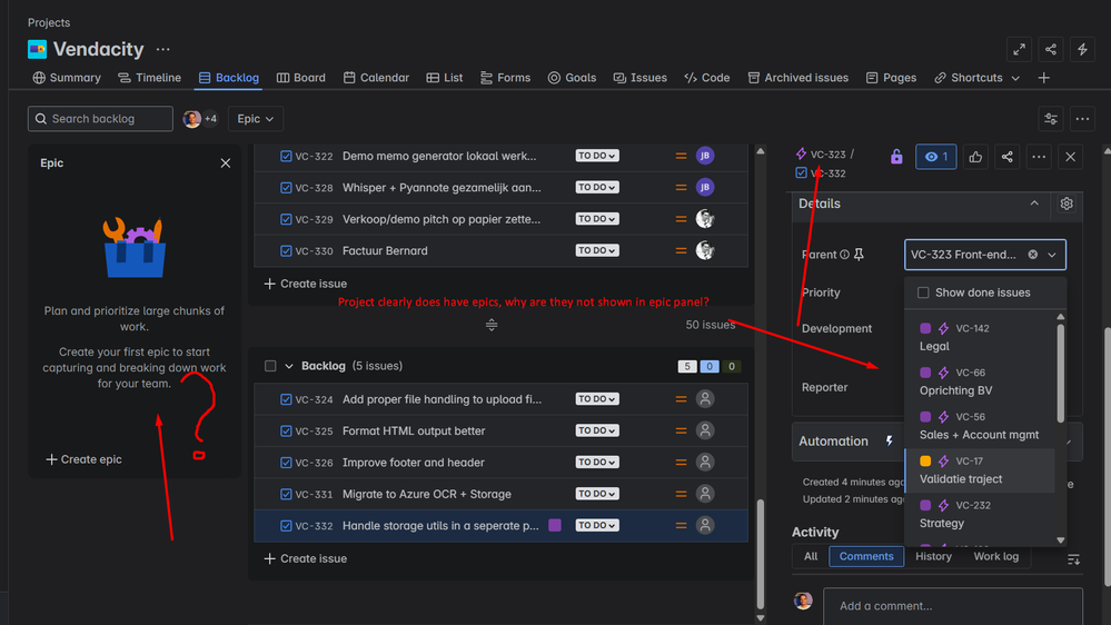

Screenshot explains my issue pretty well. Why are there no epics shown in the epic panel even though I do have epics?

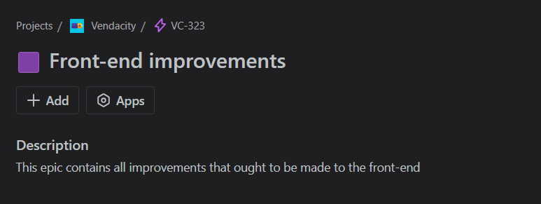

Thank you for the quick response! I don't think any of the epics has a 'done' status category. In fact, they don't seem to have a category at all:
None of the epics are done. The type of the project is:
The board that I made a screenshot of is indeed the 'default' board. Do I have to create a new kind of board to be able to filter on epics?

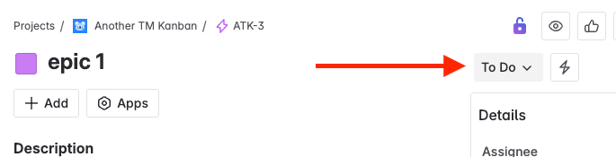

All work items have a status, which is included in a Status Category. When viewing the item details you will see the Status in a colored lozenge on the right above the Details panel.
If the Epics don't show a green lozenge there, then generally they should be displayed in the Epics panel in a Team Managed Software project. You should not have to create any additional boards.

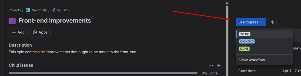

All my epics have a To Do/in progress status; like screenshot shown below:
Issue persists in another browser/in a private window of same browser. I will check one of my colleagues does also experience the problem.

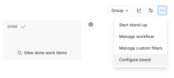

Can you check the mapping of Statuses to columns for your board and confirm that the Statuses used by the Epics are mapped to board columns?
Click on the ... button on to the right and slightly above the columns when viewing your board, and select Configure Board.

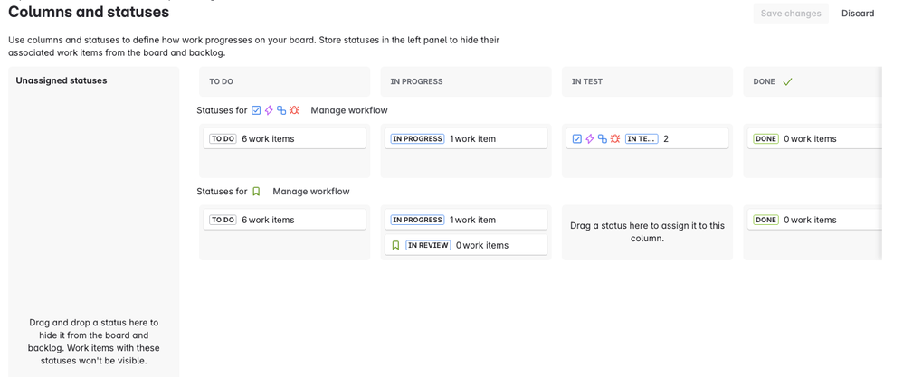

That should give you a screen that looks similar to this.
Do you have any statuses in the Unmapped statuses area on the left? If so, try adding those to the appropriate columns and see if the Epics are then revealed in the Epics panel.

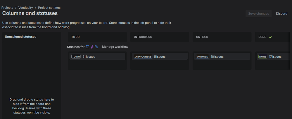

Thanks again for the quick response. There don't seem to be any unmapped statuses;
Also, my colleague got back to me and he has the same issue:
