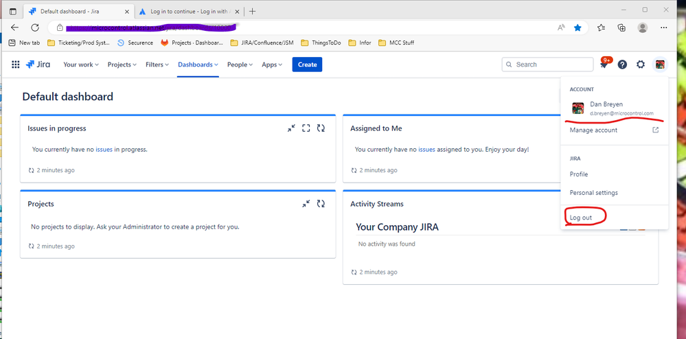

Dan Breyen
February 16, 2023
@Andy Heinzer I've replicated this in Atlassian Cloud on both Chrome and Edge.  If I have a Jira window open, looking at my dashboard, I can see all my data.  Next open Confluence in another tab.  On the Confluence tab, if I logout of Confluence, The Confluence window says I'm logged out, but when I switch back to the Jira window, it acts like the user is logged out (because the dashboard updates) but it clearly shows that I'm logged in. (See attached Screenshots). It seems that logging out isn't clearing everything out as part of the process of logging outConfluenceLoggedOut.pngJiraLoggedInOut.png
