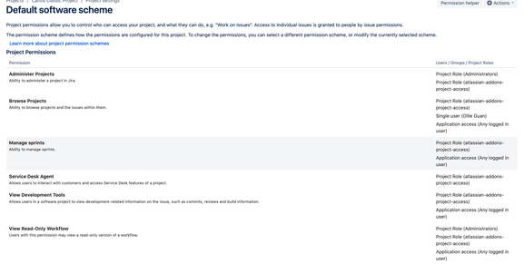

This permission is called Manage Sprints. You can find more info here:
https://confluence.atlassian.com/adminjiraserver073/managing-project-permissions-861253293.html

Hi, I also have the same problem. I don't have option "Create Sprint" on my project board. I checked my permissions and I'm "Administrator" for this project.
What is interesting that another person on this project, who has permissions "Administrator" does see option "Create Sprint" on the same project.
She was the one, who created the project.
Would it be true that only one Administrator can create sprint?
Hi Olga,
I don't think so. Anyone with the Manage Sprint permission should be able to create the sprint. Did you check if this permission was assigned to you (or to a role/group to which you belong)?
