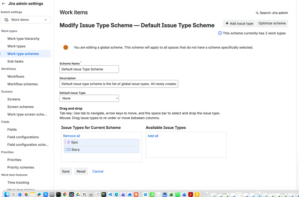

The issue is that rovo is not aware of what version of product a user is in that is asking questions, and contineously guides based on assuming Jira classic is being used.
The configuration path that is being attempted is working over task type (only epic and story are shown in the task management and scema screens) triggering me to attempt to "add" or "create" them while rovo points out "dont do that they are there but now shown".  The actual list of task types configured are "Epic, Story, Task, Sub-Task and Bug".  This missing information extends into the automation creation and prevents being able to set up based on what should be available as a type.
Across multiple issues that I've discussed with rovo, it keeps stating the same thing, that the current cloud user experience is sub-par.
What I want is to be able to run a project in classic, that rovo can properly guide me within, and not have it give up and point out things are not complete and documentation doesn't exist to properly address how to do whats needed.
I've been working in Jira across data center, and cloud across multiple organizaitons since 2007.

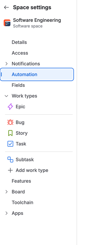

What is the type of the project with which you are having the problem? As you may already know you can find that information in the Type column on the View All Spaces page, or by clicking on the ... next to the Space name in the navigation panel on the left and reviewing the last two lines in the pop-up that displays.
If I understand correctly the problem you are encountering is that you believe that for the project/space you are using the task types Epic, Story, Task, Bug, and Sub-task should be available, but you are only actually able to interact with the types Epic and Story. Is that correct?

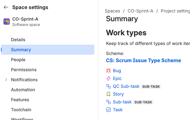

For Company Managed projects the issue types available are controlled first by what is defined globally at {yourBaseUrl}/jira/settings/issues/issue-types, and then by the issue types available in your Issue Type Scheme shown in the Space Settings in the Summary tab.

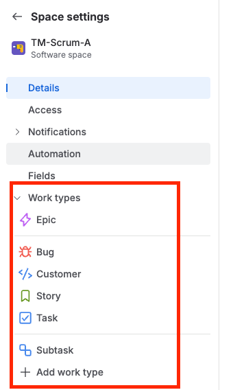

For a Team Managed project the issue types are defined within the Team Managed project itself. If you go to Space Settings > Work Types you see the types already available in the project and the option to Add Work Type.
When a project/space is created there is a point in the process, depending on the project template you choose, where you have an opportunity to switch between proceeding with the template to set up a Company Managed project or a Team Managed project.
If you can provide us with the context of the type of project you are using, and what work item types are available in it based on the Space Settings, and where you are expecting to see more types but don't see them, we can then proceed with more debugging of your scenario.

So when stepping into the automation creation step, I ran into where there is no awareness of the Bug work type, and when going into the interface for work types only Epic and Story are listed, which then triggers (by me) attempting to add task and bug because those are needed for the logic, but I run into where its actually CREATING NEW DUPLICATE work types instead of using whats in the project defaults.
Stepping into the "Work Type Schemes" this same limited list of only Epic and Story is relflected as well, with no ability to extend it with the other types that can be seen when creating a new issue, and when interrogating Rovo to what is going on it comes back with what you saw in the attached screenshot of the attached with the final highlighted item which is 1) suprising 2) poor system prompt management by whoever is setting up rovo to allow it to flat out just bash what the user is paying for in the way it did.
As I stated rovo keeps falling back to instructing over Jira Classic configuration patterns and no matter what I prompt with for giving it context that I'm in new jira cloud, continues to deliver instructions that do not map to this new user experience, and then when challenged falls back into the same poor user experience acknowledgements and not having access to full documentation for the "new cloud experience".

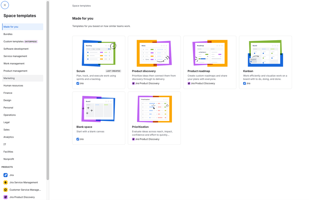

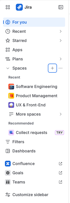

Todd Grayson
March 7, 2026
I don't think we're in the same product experience...

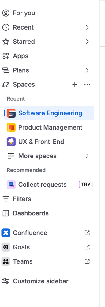

Todd Grayson
March 7, 2026
Actually I got to where you are showing, I'll see if I can get the instruction flow working from here...
Screenshot 2026-03-07 at 2.16.36 PM.pngScreenshot 2026-03-07 at 2.18.47 PM.png

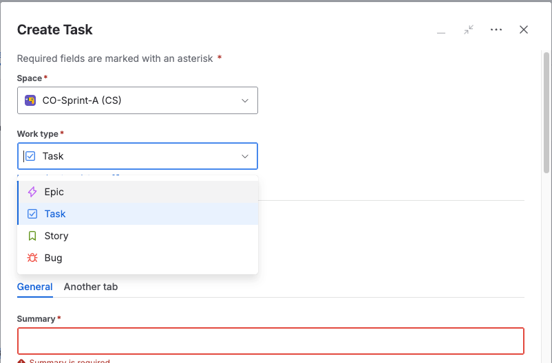

You have asserted that the other work items types exist when you attempt to create an item. Would that be in the item creation dialog? If so, have you specified there the same project/space where you want to implement the changes?
If you have specified the correct project/space in the Space field and the Work Types are available in the Work Type list, then you should not have to add the work types to that project.

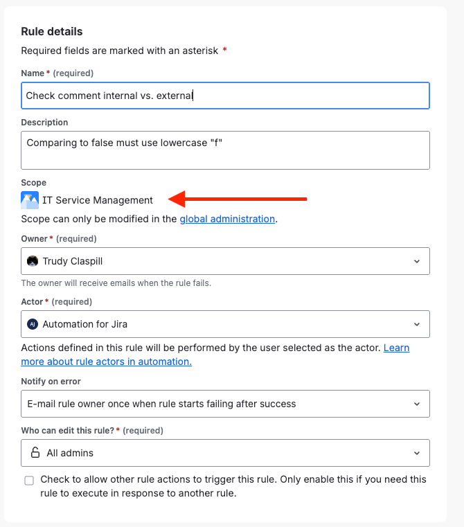

If you are not seeing the same work types when you are working on the Automation Rule, please let us know the following:
What have you specified as the Scope in the Rule Details for the rule? Does this identify the same project where you want to implement your changes?
Can you provide a screen image of he specific step in the rule where you are trying to select the missing work item type, showing how you are trying to specify that work item type so that we can see that it is not possible?
Trudy Claspill
March 7, 2026
I did not see your last screen images from Space Settings before posting my reply.
Based on that image you are in a Team-Managed project. In that case Work Item Type Schemes do not apply.
Let us know what questions come up next.

Are you running within a standard or premium/enterprise license level?
I am familiar with team managed projects/spaces, and have worked in company managed project contexts before (and migrating everyone out of team managed and into atlassian professional services managed "company managed" deployments at the large enterprise level and all the gnashing of teeth that ensued).
I'm locked in by the license level of standard to only being able to access the add spaces context.  Global settings does not let me change anything to handle this either.
There is no "create new project" context in my menus, anywhere. I only have "Create new Space", even under customize sidebar there is nothing there that helps.
Note the elipse just takes me to manage spaces and create new space ends up on the same selection "Mode for you" page
Show me your menu context that offers it and your create new project screen, here is mine:
Screenshot 2026-03-07 at 4.08.08 PM.pngScreenshot 2026-03-07 at 4.09.22 PM.png
Todd Grayson
March 7, 2026
Trudy, I found it, it was a few configuration levels below that, the selection was not apparent when I went through it setting up the projects.  I've created a test project to validate I can get everything configured, thanks for pushing on the fact that Rovo lies like a dog.
