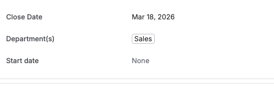

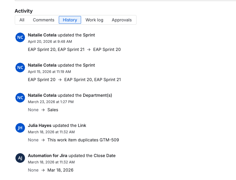

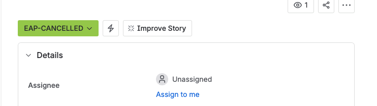

We noticed today several stories that were in cancelled status, but were pushed to the next sprint. How do I stop this?
Screenshot 2026-04-20 at 11.46.03.pngScreenshot 2026-04-20 at 11.46.07.pngThe most activity on April 15, 2026 at 11:19am shows that when the previous sprint was closed and new sprint started during our sprint planning call, it pushed this cancelled story into the new sprint (even though it is in cancelled status). Screenshot 2026-04-20 at 11.46.24.png
