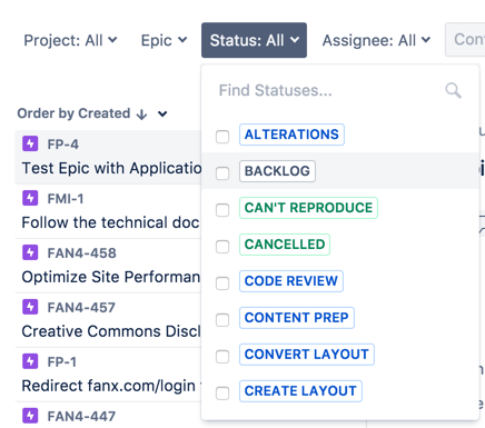

Yes, but the second I introduce a specific Project, I am no longer able to filter on most of my Status values (from the Project's workflows). So if I leave Project to ALL, I can't get my Application Area filter, and I specify a Project, I can't get my Status filter...

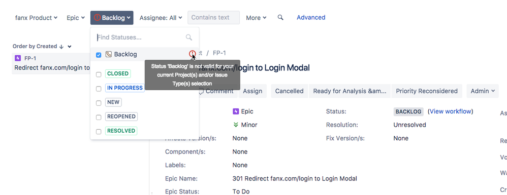

If you switch to the Advanced view and type in status = "Backlog" does that return anything?
Ben McPhee February 2, 2018
It results in the following error, even though, as you can see in the background, Backlog IS a valid status for an Epic in this Project...

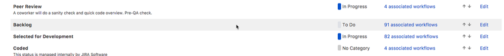

Does the Backlog status have a status category?
You can check by going to JIRA Administration -> Issues -> Issue Attributes -> Statuses
If it doesn't have a category can you give it one and see if that resolves your issue?
Yes, it has the Category of "To Do":
The other Statuses in the workflow also have Categories and are not displaying / being found...

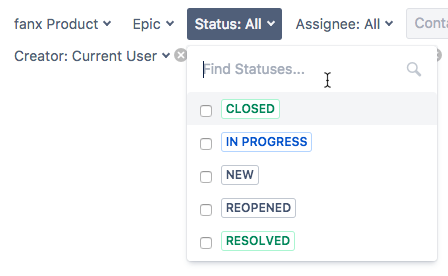

So...ALL the statuses appear and are accessible when I remove a specific Project...even statuses that do NOT apply to that Issue type in the workflow (so that, I suppose, fixes it since we'll only be working in one Project):
but the second I select the Project, those statuses disappear.

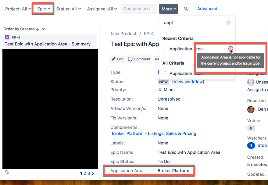

And then another issue arises: similar to the Status issue, when I try to select a custom field of "Application Area", that CAN be selected on the Epic, it tells me that that is not a valid field, when clearly it is...
Thanks, Tyler - unfortunately, it only solves part of the problem now because I cannot apply a filter on a custom field since I am not selecting a Project to which that field applies...
To fully solve the issue, I need those Statuses to appear when a Project is specified...
