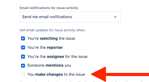

What do you mean by "comment to myself"? Are you mentioning yourself in a comment?
Do you receive email notifications for other changes you make to the same issue?
Click on your avatar and select Personal Settings. Do you have this box checked or unchecked?
If the box is unchecked then you will not receive email notifications when you mention yourself in a comment, nor for any other change that you make to an issue.
Ralf Putter
November 23, 2023
Indeed I meant email notifications to myself.
But thank you very much, checking the box "You make changes to the issue" was the solution for my problem. Everything works well now again.
