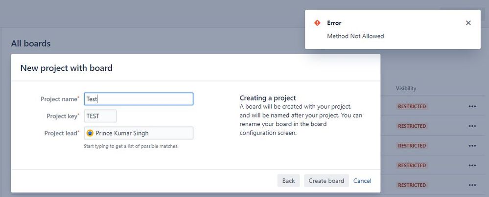

Why am I unable to delete a Kanban board?
Anurag Sonawane
June 29, 2020
Whenever I try to delete a Kanban board "Error: Method Not Allowed" is being displayed... Please help me with this...JiraError.JPG

Anurag Sonawane
July 4, 2020
Hi Angélica,
Thank you for your reply...
PFB console log of the error occurred while creating a Kanban board (same error occurs while deleting a board), PFA image too:

Angélica Luz
July 21, 2020
Thank you for the details, Anurag.
Just to make sure that we are on the same page, are you facing this issue on a Jira Cloud site?
If that's the case, I see that there are three administrators and a total of 125 users, so it would be good to confirm the permissions and if other users are facing this issue.
Also, since the site is a Standard one, if the issue is not related to permission, your site administrator can create a ticket on support.atlassian.com/contact for them to access the site to check what is causing the issue.
Like anurag.sonawane likes this
anurag.sonawane
July 21, 2020
Thanks for the reply, Angélica.
The issue has been resolved by shifting the Jira VM to another domain. There was some proxy server issue.
Like Angélica Luz likes this
