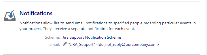

It affected all projects that had any spaces in their "name" part of the email address. This was going from Jira 6.3 to Jira 7.13.
The fix that was applied to all such Projects was to replace any such whitespace in the email address. In the example screenshot below, what was previously "JIRA Support" was replaced with "JIRA_Support". (An underscore was inserted where there used to be simply whitespace. The "do_not_reply@ourcompany.com" was unchanged (except I replaced our company name with a dummy for this example).
Outgoing mail settings are fine. This only applies to when someone uses the "@username" function to "mention" a user in an issue. All other notifications and emails from JIRA worked fine.
As mentioned above, we fixed it by applying the underscores where needed - but this was unusual, I thought.

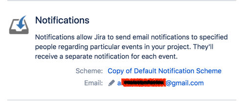

Thanks for clarifying, mine looks somewhat different.
I don't have the "JIRA_SUPPORT" that prefaces the address like yours does.  Obviously I'm using gmail.  Perhaps you are using a different mail provider here. Could you let me know who your provider is?  Is this exchange, or outlook365, or some other mail service?
I am curious to see just entering the email address is a valid option here.  Perhaps it is not given the nature of the email provider here.  However our own documentation on setting this up doesn't appear to use the format you are using here.  I'm interested to learn why your notification scheme is setup with this format as opposed to being just the email address itself.

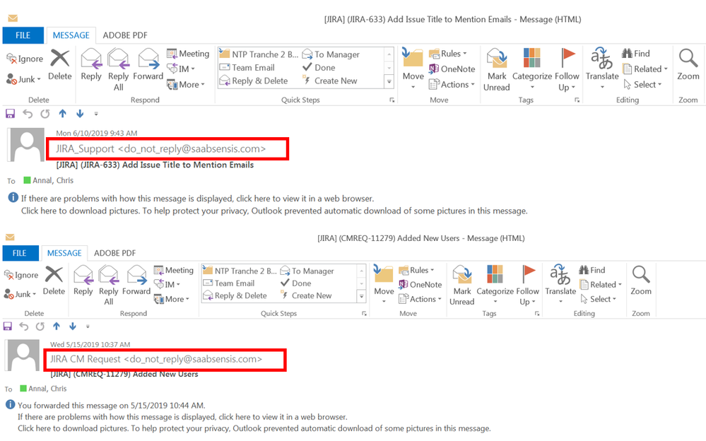

The setup reflects the name of the Project that generated the email. The braces (< >) enclose the actual email address, while the text prior to that reflects the name of the project that the email was generated from. In the examples below, you can see that one Project (JIRA_Support) generated a notification regarding an issue in that project, while another Project (JIRA CM Request) generated a notification regarding an issue in that project. Since these are all just notifications, we don't want users actually replying to them, but by using a project-specific name like we do, users can configure their email rules (Outlook) to filter for different project notifications if they want to.
In the Administration / General System settings we use:
Email from${fullname} (Jira)
(NOTE: The "JIRA CM Request" has since been changed to "JIRA_CM_Request" in order to restore the "mention" functionality, but as noted above, that wasn't a problem with other notification types coming from JIRA). Our Confluence and JIRA
