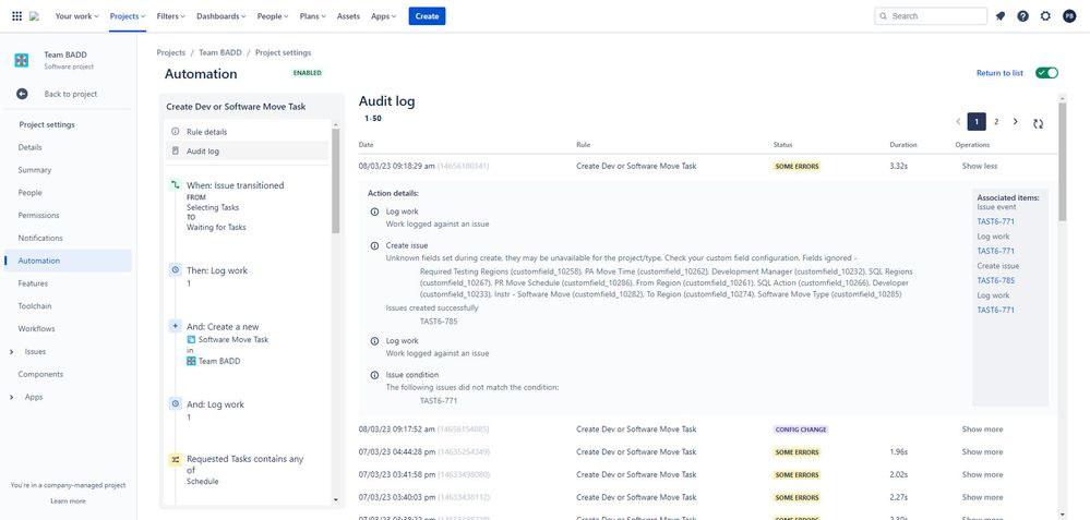

My automation to copy custom fields from an issue to a sub-task has this message in the log:
   Create issue
   Unknown fields set during create, they may be unavailable for the project/type. Check           your custom field configuration. Fields ignored -
   Required Testing Regions (customfield_10258), PA Move Time (customfield_10262),               Development Manager (customfield_10232), SQL Regions (customfield_10267), PR Move       Schedule (customfield_10286), SQL Action (customfield_10266), Developer                             (customfield_10233), Software Move Type (customfield_10285)
   Issues created successfully
   TAST6-772

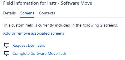

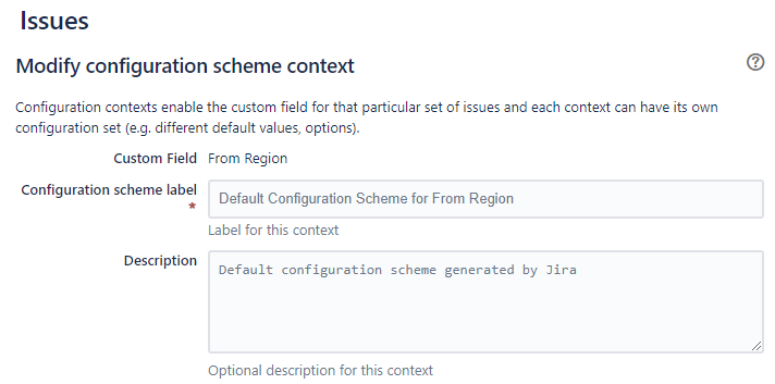

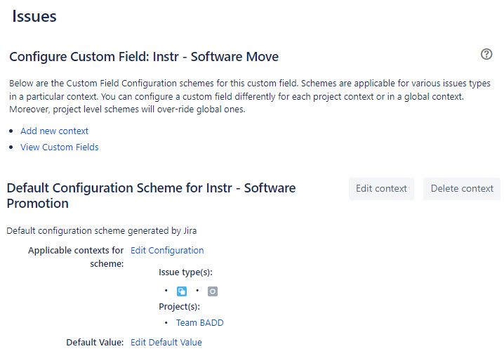

Hi Phil - you need to show the full Context for the custom field - not the Field Configuration.
Go to Settings > Issues > Custom fields
Search for the field, click the 2 dots menu to the right and select Contexts and Default Value.
Also, make sure all of those fields are on the Create screen used by the Sub-task issue type for that project.
Phil Bustin
March 7, 2023

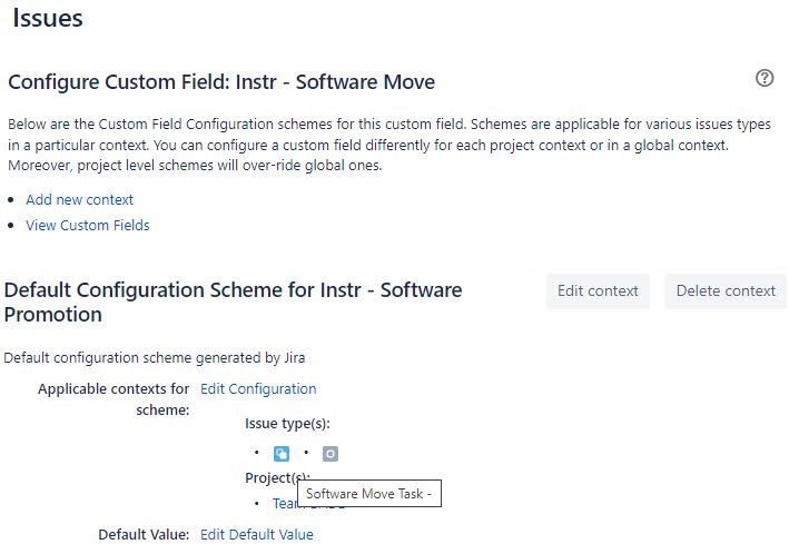

Here hopefully are the screenshots you mentioned.  Please let me know if you need more.  The fields are on both the parent and sub-task transition screens.  There is no Create screen for the sub-task, since the sub-task is always created with an automation.  I doubt that this is relevant, but I renamed the create transition.
John Funk
March 8, 2023

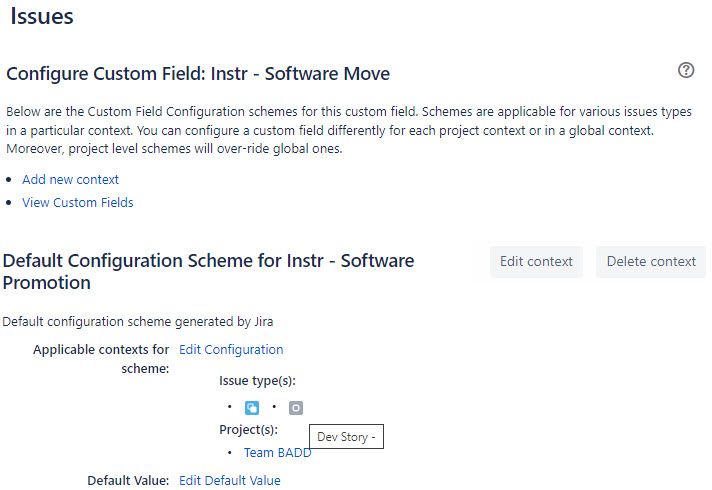

So I see that there are two issue types that are connected with the Custom field. That means that only issues with one of those two issue types will work and not give the error.
So you need to see what issue type you were using for the Create.

Issue Types revealed with mouse hover in configuration function
1) Software Move Task Issue Type (sub-task)
2) Dev Story Issue Type (parent)

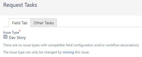

Dev Story Issue Type shown in Request Tasks transition screen (in parent workflow)

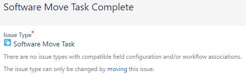

Software Move Task Issue Type shown in Software Move Task Complete transition screen (in sub-task workflow)

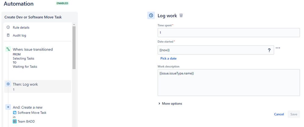

Automation rule and log

Incidentally, why does my log work action not result in the display of the Issue Type or Issue Type name, and is there a better way of trying to display that in the log?
