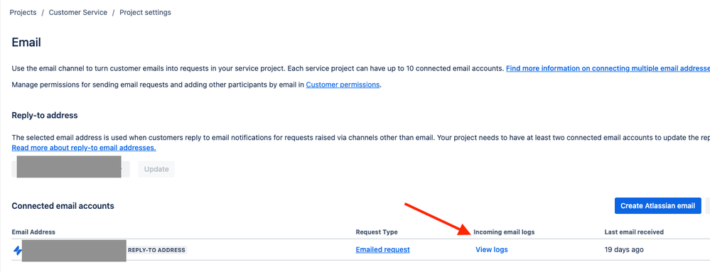

Did you check the email audit log for the project to see if there is information there about the processing of the user's email?
Go to Project Settings > Channels & Self-Service > Email. You should find a View Logs link in the Incoming Email Logs column.
Valerie Zoltobroda
December 9, 2024
There is nothing. Maybe it was because the type of request sent by email was not active. I activated it and I will check tomorrow if it is better this way! I will tell you, but already, thank you for your help
