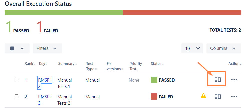

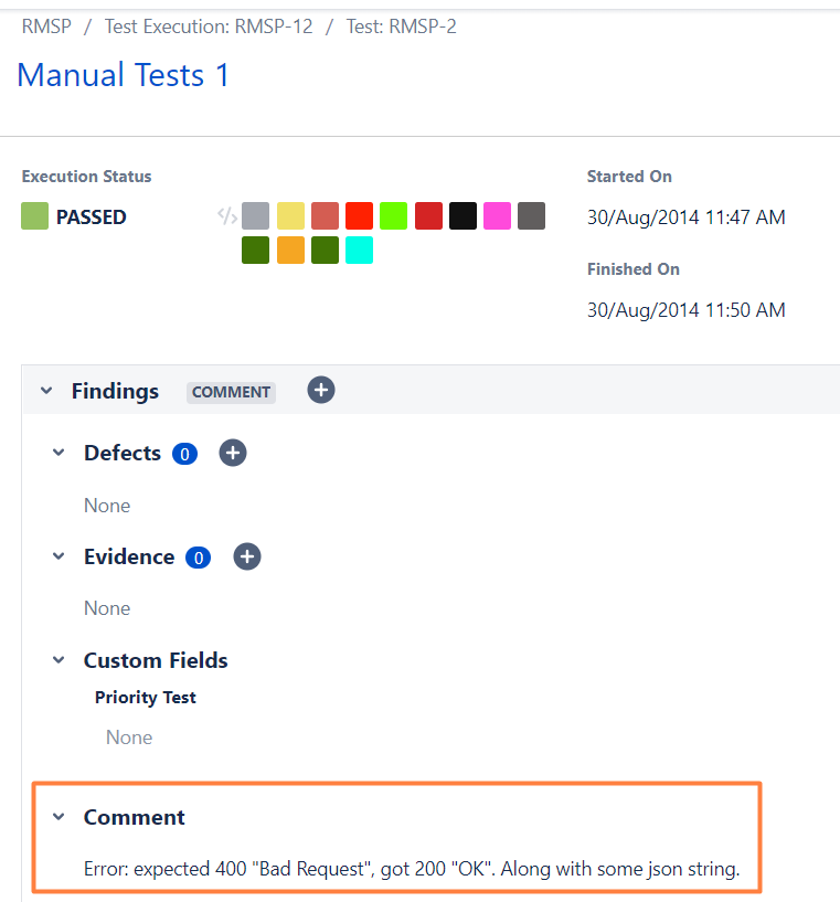

The comment is added to the Test Run and can be viewed in the Execution Details screen:
And the Test Run only exists if you have two issues, the Test case, and the Test Execution.
So to alter the information in a Test Run, it is necessary to have both keys (The test key and the Test Execution key).
The example you have shown above does not have a Test Execution key, so Xray cannot find the correct Test Run to modify its comment.
