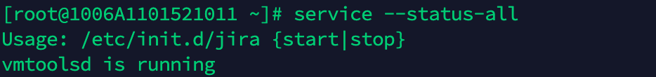

After installing Jira Software on REHL 8, whenever I try to access it using http:serverIP:8080 it doesn't show anything.
I have checked running services and it shows as attachment 1.

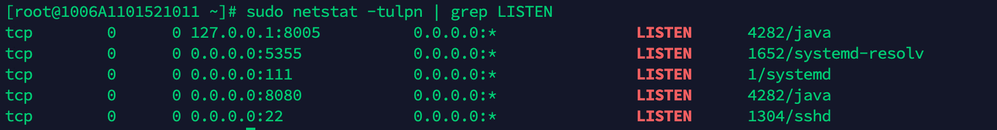

Also the sever starts listening on port 8080 whenever I start the service (attachment 2)

I used the installer, I can start / stop the service and tomcat starts and stops as well, however it is not reachable from outside the server on port 8080.
I have tried to telnet the server and I got connection refused, could this be the issue?
Daniel Ebers
July 3, 2020
Hi Ahmed,
yes - "connection refused" mostly tells that the port (8080) is not reachable. Assuming from your screenshot that Jira is running.
Best guess at this point is an activated firewall. You stated the system is based RHEL 8 - I came across a few cases where a firewall was active on RedHat based systems - right after installation.
If this should not apply then a further inspection of the log files would be needed.
