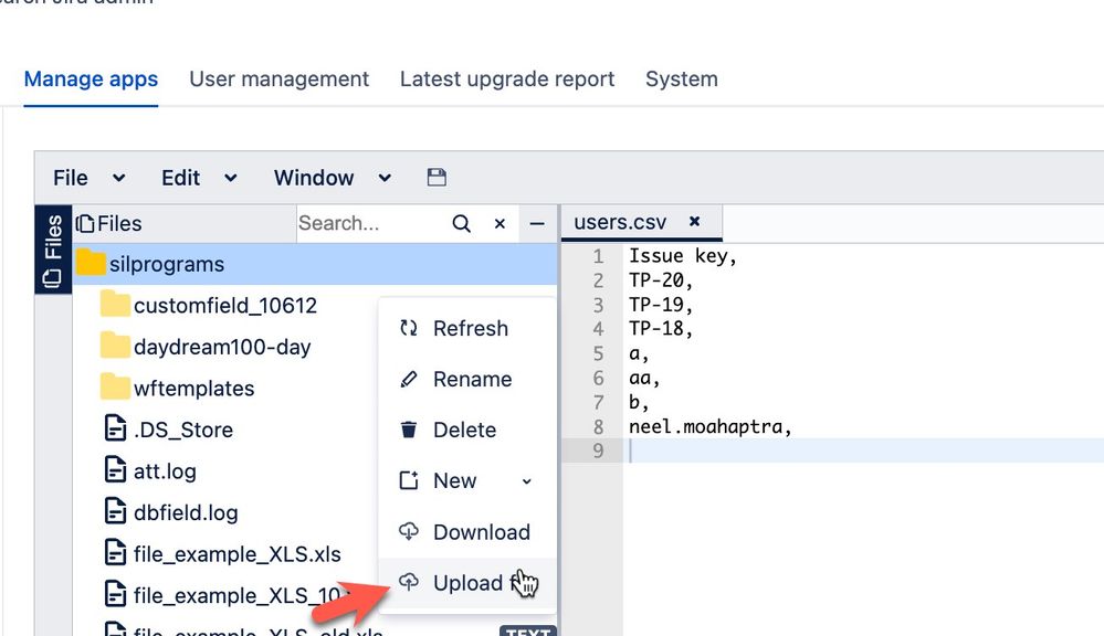

if you have latest version of power script installed you will be able to upload the csv file into the silprograms folder, just by right clicking on it.
else you can manually move the file under silprograms.
it should look something like this.
then you can use the code i shared above and  make sure to check the script before clicking on green play button. if there are any errors it will show it to you .

Hi @Gaurav Kumar ,
Looks like the script is not able to find the CSV file.
Did you make sure you have a users.csv file under silprograms folder?
the csv file should contains the user names, just to let you know key word "issue key" is not needed.
Did you try to upload the csv file? or did you place the CSV file manually into the silprograms folder?

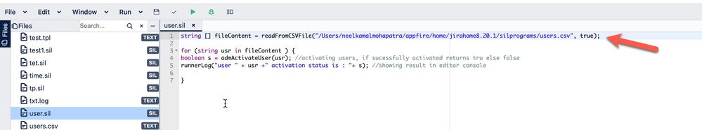

you can also use the complete path of the file.
It is advised to use the file inside silprograms folder so that there is no  permission issue.

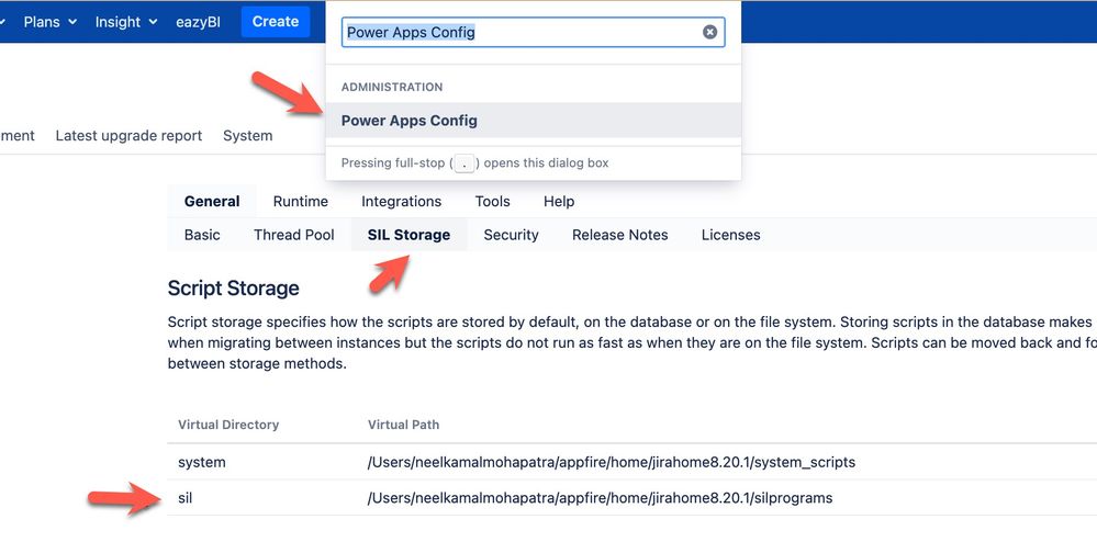

to check the full path of sil programs you can go to power app config and look for sil storage as shown below.
then you can use the complete path of the file.

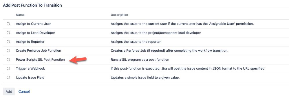

Yes , that can be done simply by adding the script in the post function of assigned transition.
if you have to have the user details in the custom field, then instead of csv file you can use the field to get the user details.
string usr = customfield_name;
admActivateUser(usr); //activate user
in the post function of the transition, please select the power script SIL post function and then select the above saved sil script.
Every time the transition happens, the script will take the user from the custom field and then try to activate it.
