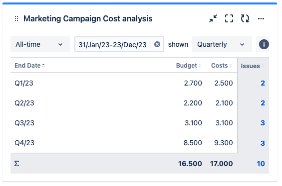

if an app is possible, I can recommend our app sumUp for Jira. We deliver four additional dashboard gadgets in which we provide summarizing functions. For example, we deliver a Two-Dimensional Filter Result gadget, which includes a totals row and column and, more recently, a date functionality in which you can quickly change the time period and the display (e.g. weekly, monthly, quarterly) in the gadget.
Here is an example that comes relatively close to yours:
The important thing here is that these are transaction-related fields.
