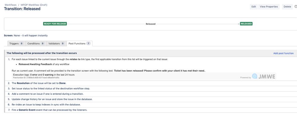

I did...which adds a little to the confusion. In this specific case it's moving from Released to Needs Requirements.
For each issue linked to the current issue through the relates to link type, the first applicable transition from this list will be triggered on that issue:
Run as current user. A comment will be provided to the transition screen with the following text: Ticket has been released! Please confirm with your client it has met their need..

You apprently checked the post-functions on all transitions that can lead the parent issue back to "Needs Requirement", and the only one you found was on a transition from Released to Needs Requirements, and it triggers a "Released Awaiting Feedback" transition. What does that transition do? Also, it would have added a comment on the linked issues, and that doesn't seem to be the case.

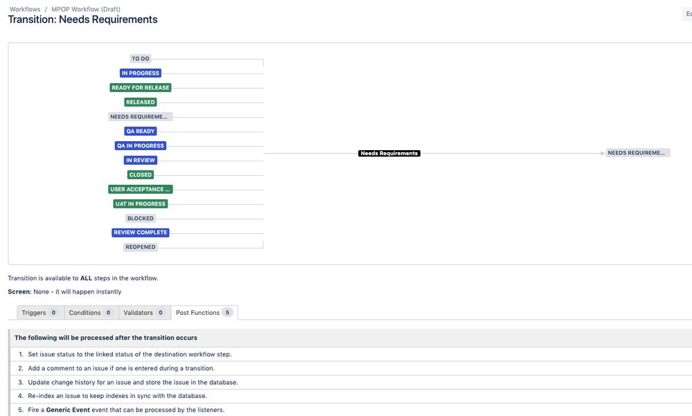

Also, since the Status change made by JMWE is from "Needs Requirements" to "Needs Requirements", that means JMWE triggered a transition that _can_ start from "Needs Requirements" and that leads to "Needs Requirements". Do you have any like that?

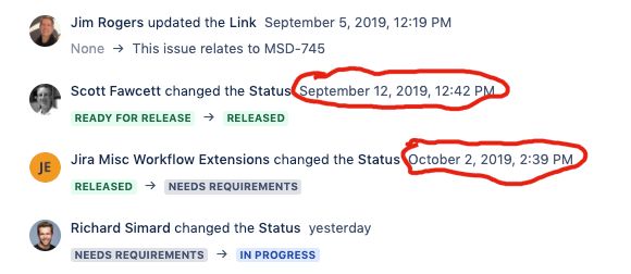

Finally, when the parent ticket was changed back to Needs Requirement, can you check in the parent history who the user was who made the change (to the Status field)?

Let me clarify. The original ticket was changed by JMWE from Released to Needs Requirement. No user made the change. That is the problem I am trying to debug...because the last thing I need is Product Managers reviewing tickets that have already been released...which is how this was found.
The ticket that changed from Needs Requirement to Needs Requirement is a Related To ticket (linked to the ticket that changed from Released to Needs Requirement) and the transition was also made by JMWE (and we don't know why).

What would make a post function transition happen 2 weeks later? These tickets were in a state on Sept. 23. JMWE transitioned them on Oct. 2. There is no History of changes between those timestamps...so no user interaction.

I've attached what I'm looking at in the workflow. If that's not the right spot, or something clearly points to the problem, that would be awesome.
