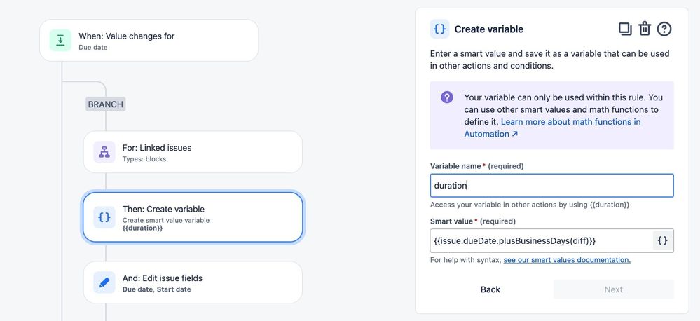

Joe Mraz
August 23, 2024

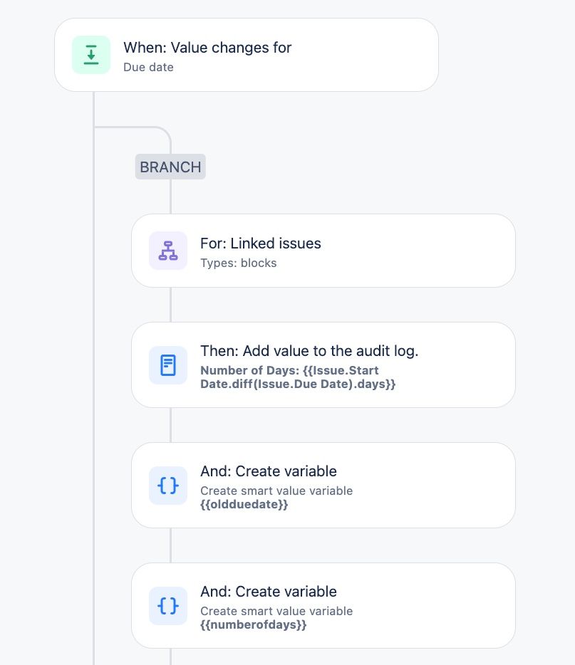

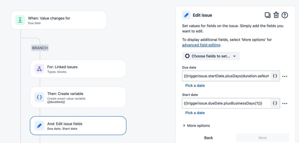

Here is part 1:
Joe Mraz
August 23, 2024
Part 2:

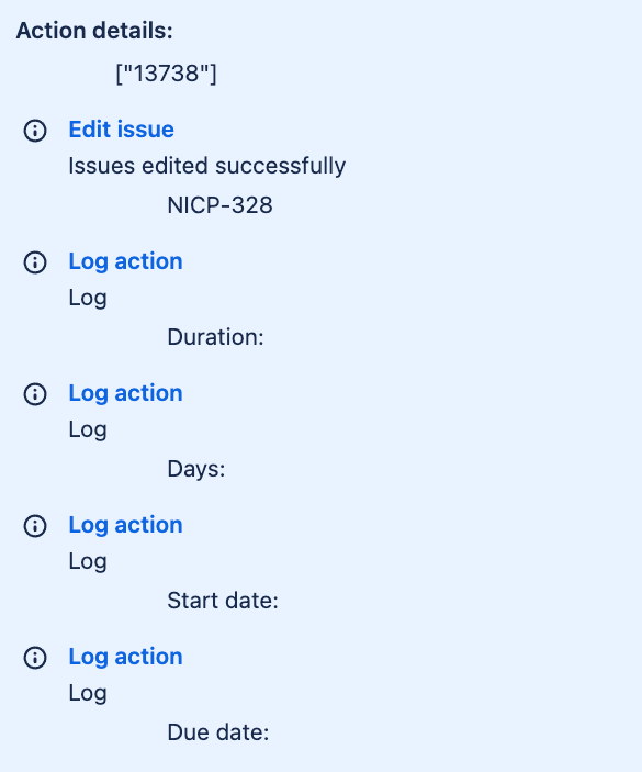

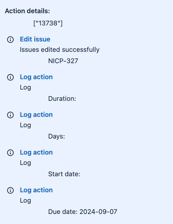

Success Info from Log 1st one: Notice only the Due Date is there which correctly sets the start date on the next story
Joe Mraz
August 23, 2024
Success Info from log 2nd one: Notice everything is blank

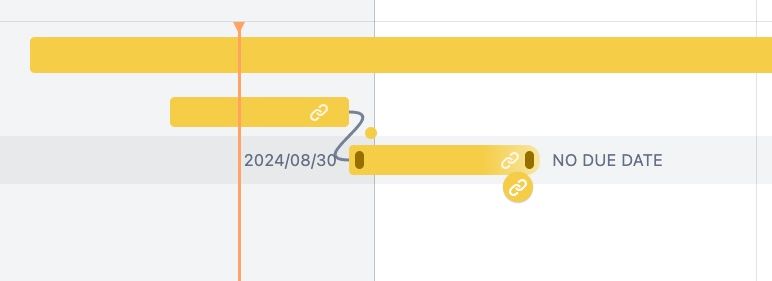

Joe Mraz
August 23, 2024
Results: The 2nd story has the correct start date but due date is now saying NO DUE DATE

Bill Sheboy
August 23, 2024
Hi @Joe Mraz -- Welcome to the Atlassian Community!
In your rule's create variable action for "duration" you use this smart value expression:
{{issue.dueDate.plusBusinessDays(diff))}}
That is not valid as "diff" has no meaning / value there.
Were you trying to use the change in value for the Due Date of the trigger issue?  If so, that would need to be calculated from the changelog after the trigger and saved for later use in the branch.

Bill Sheboy
August 23, 2024
Thanks, Trudy!
The definition of the duration variable and increment of the date seem comingled / different from your linked solution.  If they are separated again it should work, with the key being how much to increment:
  1. by the same amount as the trigger issue's due date change, or
  2. some other amount.

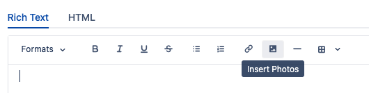

@Trudy P Claspill Hi Trudy, is there a way I can attach the files so you can see?
Joe Mraz
August 23, 2024
@Trudy P Claspill I did not upload.  I just cut and paste the pictures.  Is there a way to upload .jpeg files?
Trudy P Claspill
August 23, 2024
Save a copy of the file on your local system then use the Insert Photos option to insert/attach the jpeg to the post.

Trudy P Claspill
August 23, 2024
@Bill Sheboy 's comment about your Create Variable action to calculate "duration" is wrong. Compare yours to mine from the reference post.
I used {{issue.Start Date Field Name.diff.(issue.Due date field name).days}}
I would amend that now to use the abs function also.
{{issue.Start Date Field Name.diff.(issue.Due date field name).days.abs}}
You used:
{{issue.dueDate.plusBusinessDays(diff)}}
That is an entirely different calculation to add a number of business days to the Due Date, with that number of days being specified by diff
Because of that problem your editing of the Due Date field in the Edit action will not be correct.
In addition, you may want to double check that the linked issue actually has a Due date value and a Start date value before you calculate duration and edit the issue.

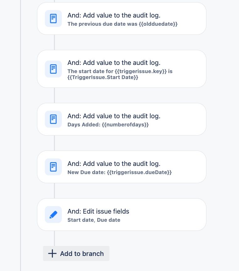

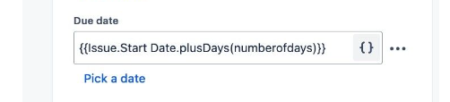

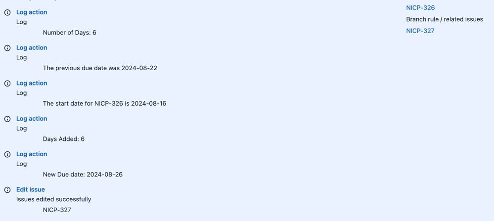

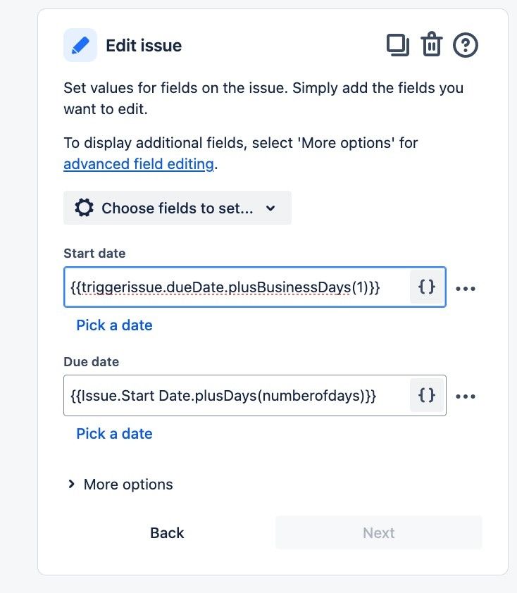

Still not working. I cannot set the Due Date. My logs show how many days that need to be added but it keeps saying NO DUE DATE.  Very frustrating.  Here is everything again because I made a lot of changes.  All my logs show data.
Trudy P Claspill
August 26, 2024
The use of field names in smart values can be space and case sensitive. Make sure that the field names you are using in the smart values match the field names you see in the UI for the actual issues.
I see a lot of placing where you are changing case, such as
TriggerIssue vs. triggerIssue vs. triggerissue (with a lower case "i" in the last one for "issue"
So I also recommend that you make sure the case on all those references is correct.
triggerIssue - lower case "t" and upper case "I" for "Issue".
When referencing the current issue in focus use {{issue.... with a lower case "i".
I also notice that you are trying to reset Due date based on Start date in the target issue.
Two things I would recommend with regard to this:
1. Don't use the focused issue's Start date as the basis for assigning a value to this field. At this point in time, the start date of the issue has not yet been changed so it is using the original Start date in the calculation. Instead use a reference to the trigger issue's due date, like you do when setting Start date.
{{triggerIssue.duedate.plusDays(numberofdays)}}
2. Print that value into the Audit Log to confirm it is calculating correctly.
3. Also, I see that you are actually pushing the new Start date out by an additional day, so you need to factor that in to the numberOfDays calculation:
{{issue.Start date.diff(issue.duedate.plusDays(1)).days.abs}}
