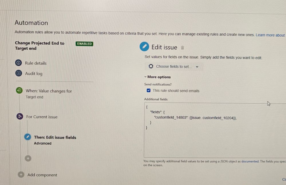

Here is what I got so far with your suggestion

Thank you for that image.
One thing to clarify is that you tagged your post as being related to Jira Cloud. The screen image you provided shows the graphics used in Jira Data Center, not Jira Cloud.
When asking for help with an Automation Rule it is important to accurately identify your hosting/product type (Cloud vs. Data Center) as the two provide slightly different capabilities.
And when the environment is Jira Data Center, it is also helpful if you tell us the version you are using, as some capabilities may not be available for older versions.
Addressing your rule, now.
First, you don't need the "For: Current Issue" branch. You can have the Edit Issue action directly after the Trigger.

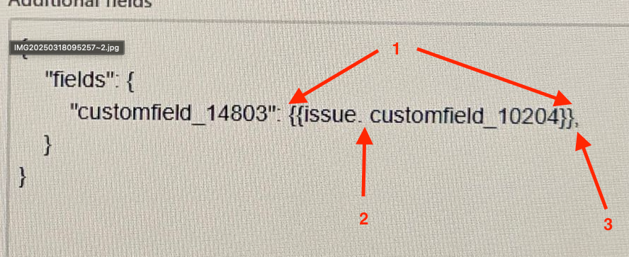

Second, there are problems in your JSON.
1. The smart value needs to be enclosed in double quotes, literally:
"{{issue.customfield_10204}}"
2. You have an extraneous blank space that needs to be removed.
3. You need to remove the comma that follows the smart value.
If you make those changes and the rule does not work as you expect, please provide screen images showing the output from the rule Audit Log for when the rule ran after the changes are made.
