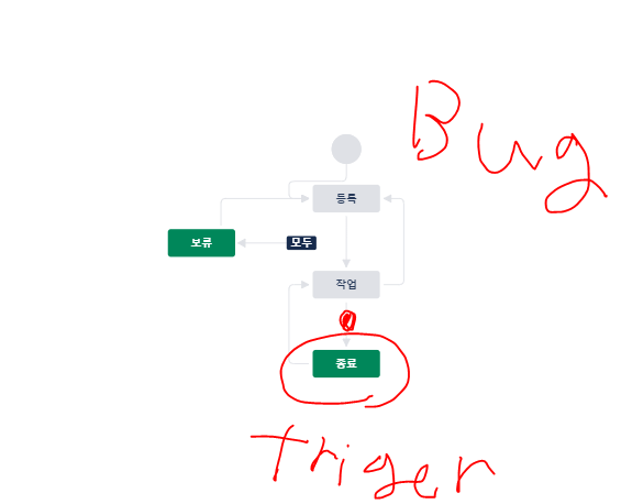

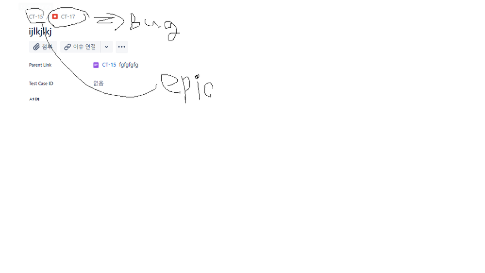

A ticket : Epic
B ticket : Bug (Issued from A ticket)
In case of above

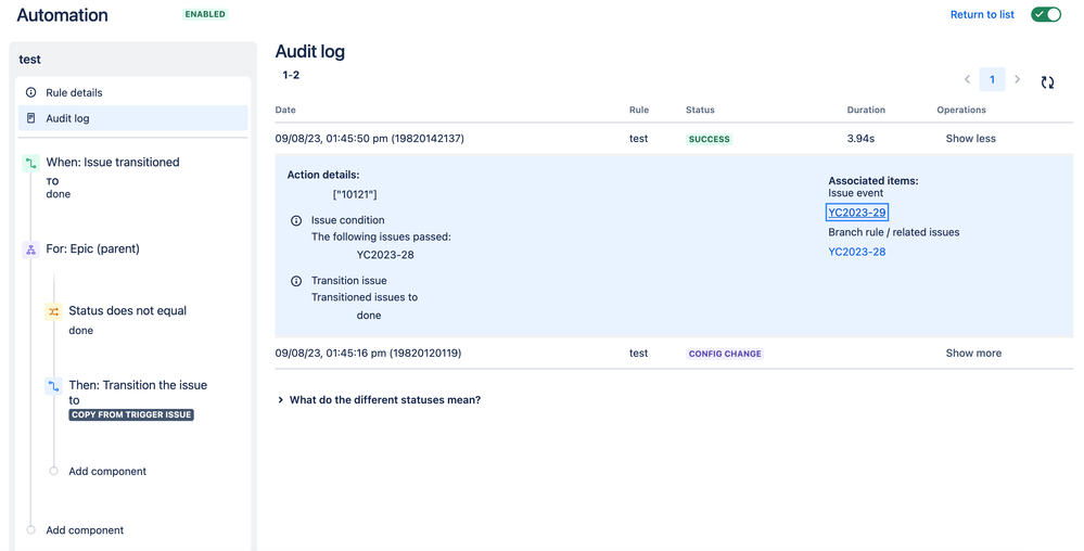

I want to change the status of the parent epic when the bug is finished.
However, if you create a rule like the screenshot, the rule just passes without any update.

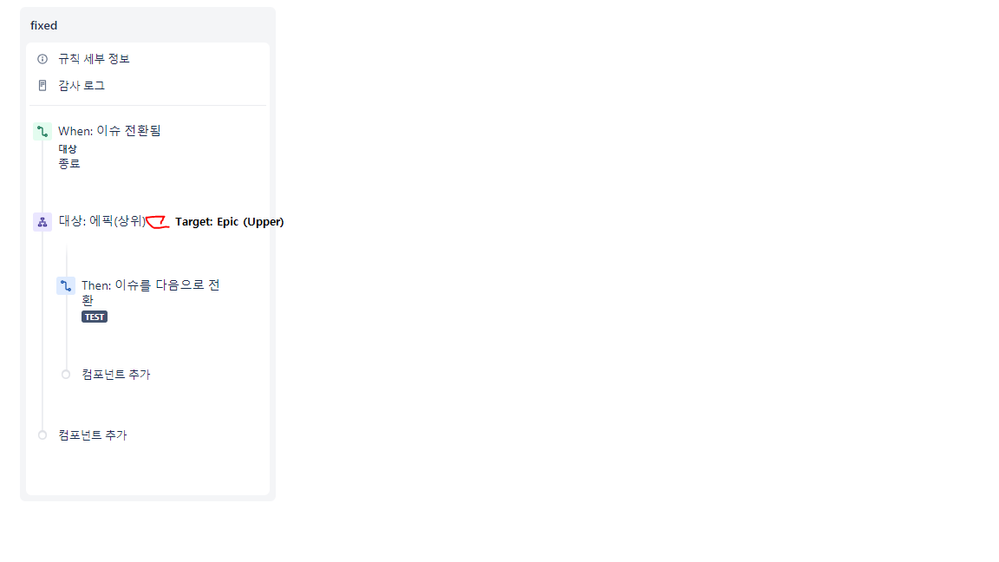

If I understand your question correctly, you want to create a rule such that when child Bug is marked as completed, the associated parent "Epic" transitions into the "Done" status as well.
Trigger: When Issue Transitioned
Branch: For Epic (parent)
Condition: If the Epic status is not Done already, then
Action: Transition Epic to the required status
 Please let me know if this helps.

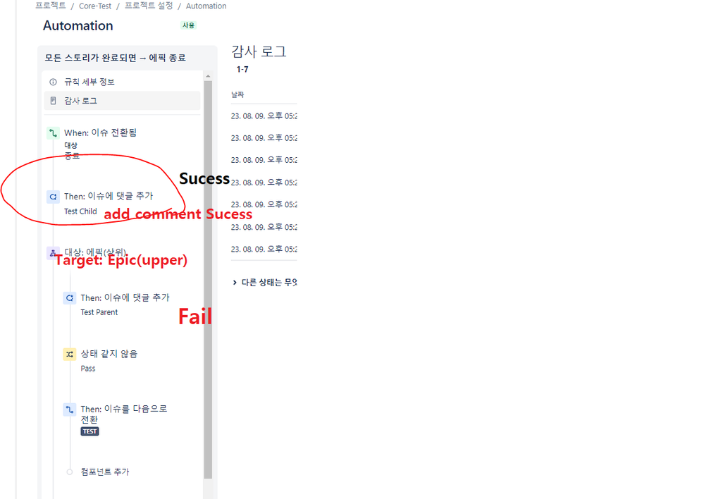

ChangSoo Yoon
August 9, 2023
the rules you sent The rules I made are the same.
However, the status did not change, so I tested it by adding comments.
The parent issue doesn't work at all.
if you  Need to know epic, bug details setting?

Hi @ChangSoo Yoon
The automation template library has kind of the default rule setup for this action.
See the rule: "When all stories are completed → then close epic"
I you want the action only for the Epic, you can adjust the rule to your needs
ChangSoo Yoon
August 9, 2023
I did a test,
But the change of the sub-issue that fires the trigger is successful (comment added)
Changes to the parent issue are still ignored (comment added)

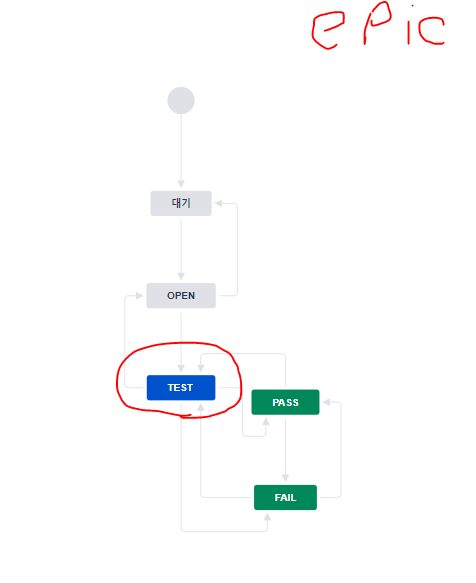

Can you have a look at the workflow used by the Epic.
If there is a transition screen on the transition you want to execute by the automation, the transition looks successfull, but won't trigger.

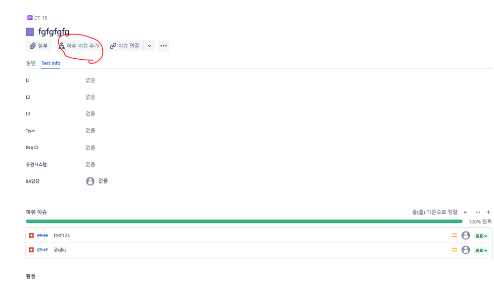

In my opinion
Can't seem to find the "upper" issue
I clicked this button
Creating a sub-issue (bug)
