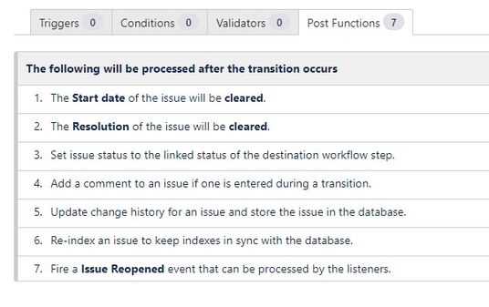

Del Jensen
August 12, 2021
When you transition to Reopened, you need to have a Post Function that clears various fields.  I've included an example of what our company uses:
Mike Hirons
August 12, 2021
Yep, we have a "The Resolution of the issue will be cleared" post function - but this isn't clearing the resolution date field, which is causing the main problem.
I'm not able to select resolution date as a field to clear.

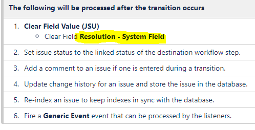

Souvik Nath
July 20, 2023
I have solved it now by using below post function in between workflow transition in my project. I am using Jira datacenter 8.22.6 version.
