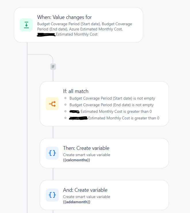

Madar_ Andrew
May 22, 2024
I am using the IF branch, and performing the calculations on this branch.  Would I be required to use the issue or triggerissue prefix?

Hi @Madar_ Andrew
Yes, and...to Kalyan's ideas:
Context is important for automation rules, and so let's look at an example rule to see which issue is "current" at different locations.
trigger: some trigger  At this point, "current issue", {{issue}}, and {{triggerIssue}} refer to the same thing.
action: some action same as above
branch: on some issues  same as above
         action: an action inside the branch Inside the branch, "current issue" and {{issue}} refer to the branched-to issue, but {{triggerIssue}} continues to be fixed.
 action: after the branch After the branch, we are back to "current issue", {{issue}}, and {{triggerIssue}} refer to the same thing.

Kalyan Sattaluri
May 22, 2024
For your rule, at least as far as shown:
  • Even if you dont give issue prefix, it will work,
  • Will work with issue prefix,
  • Will work with triggerIssue prefix.
So any of the 3 options above will give you the same result. It does not matter.
Now, if you are not seeing expected results, we have to look at your formulas.
So for that, you need to log all your values. So add below steps to your rule:
  • Add Component -> Then Add Action -> Select "Log Action". Put below value.
    • Monthly Budget is - {{Monthly Approved Budget}}
    • Addamonth value is - {{addamonth}}
    • Final Calculation is - {{#=}} {{addamonth}} * {{Monthly Approved Budget}} {{/}}
Once all added, run your rule and share your complete rule & audit log.
Thanks.
