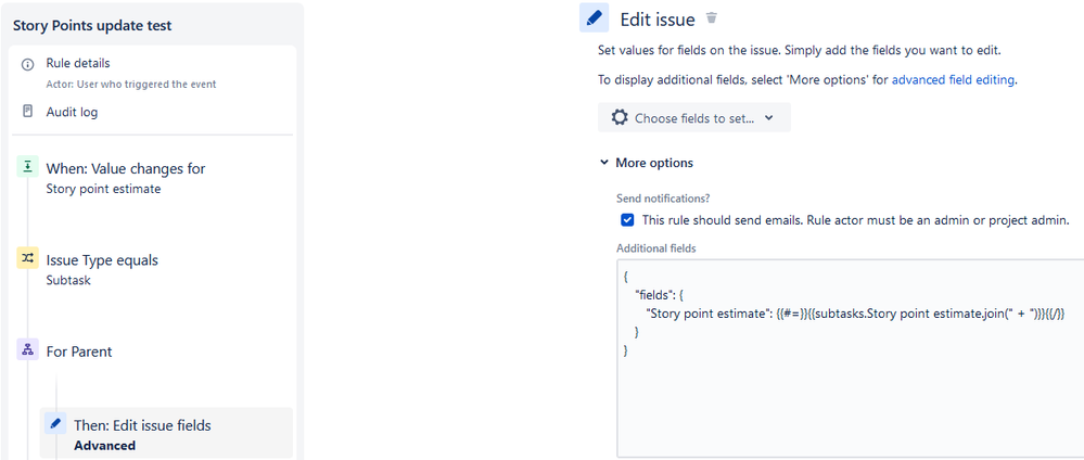

If you do: The code in the box on the right side only adds sum of Subtask story points and join them together and write that into the Story point field of the parent issue.
(It does not add the value of the subtasks to the original value of the parent)

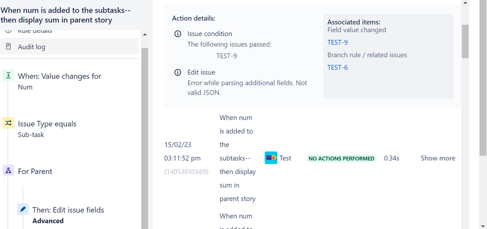

I have attached the screenshot of the rule. I have Num custom field in both subtasks and story. If story has value 10 including subtasks values ie Ex- If subtask1--5
         subtask2--5
         subtask3--5
After the rule story should display 25 not just 15 in the story. on the same custom field. Any help would be appreciated.

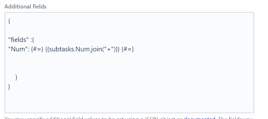

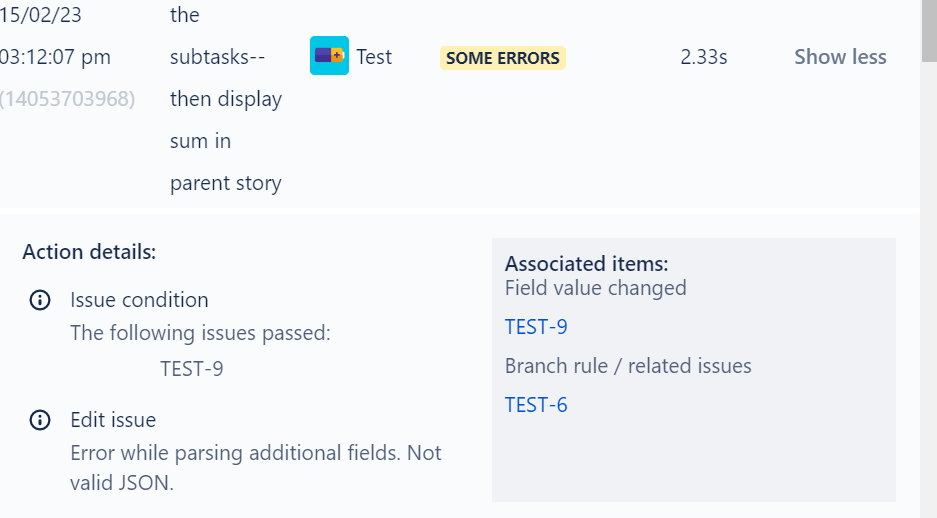

Hi @Tobias H ,
This the code being used
But i see error in the log

"fields": {
"Num": {{#=}}{{subtasks.Num.join(" + ")}}{{/}}
Could you try this code instead (basically just swapping the second #= to a /)
It will still just add the subtask Num values and overwrite whatever is in the Num value of the parent, but it shouldn't generate an error.
