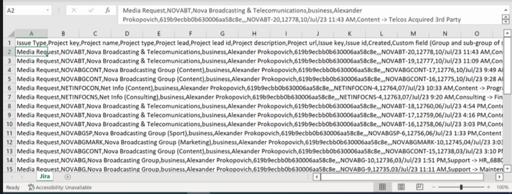

Here is a screenshot of how the information looks like, maybe it can help. This is after the affected user had performed the export.
Aron Gombas _Midori_
July 10, 2023
The cell value in the top shows that the commas are correctly added, so the CSV file itself seems valid. Maybe your spreadsheet tool does not split at the ',' characters, but something else line colon. Try to configure that when importing.

Just found out what the problem was.
The user has changed the default separator in his Excel which caused the problem. After reverting to the default ones, it all looked just fine.
