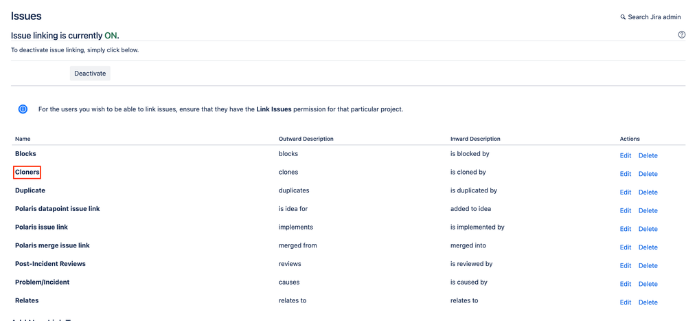

emmy
August 18, 2023
Solution:
The Issue Linking name has been renamed at some point in the past for Clones in the issue linking configuration. It needs to be named Cloners.

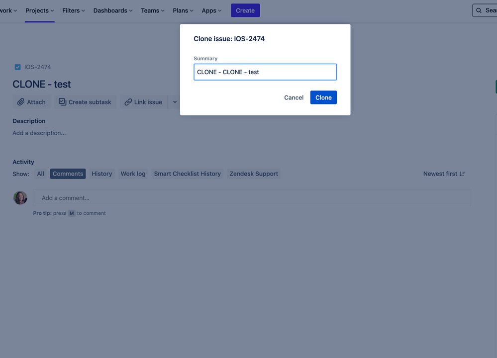

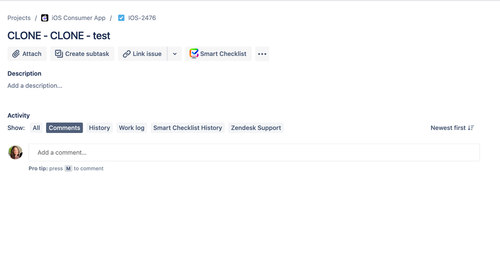

emmy
August 17, 2023
I'll be on a ticket (task, story) then click the three dots at the top right of the ticket > select "Clone" > automatically clones the ticket
The new cloned ticket does not have the original ticket linked, it used to do that automatically or atleast ask to link the ticket by checking a box before cloning.

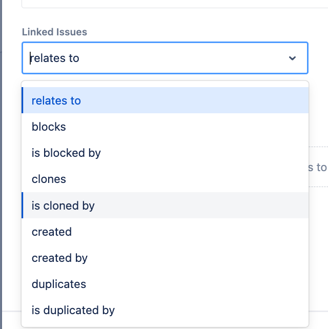

Projects are all company-managed.
I still see the options clones/is cloned by.
Screen Shot 2023-08-17 at 8.53.58 AM.pngScreen Shot 2023-08-17 at 8.54.10 AM.png
