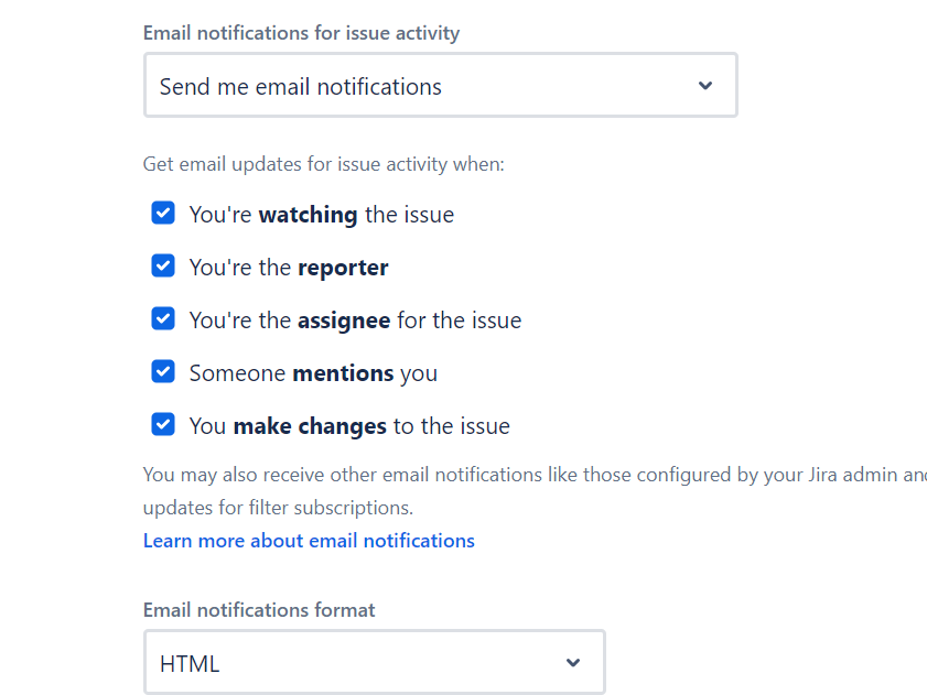

This helpful thank you. So to find the notification scheme, is it different than this?
Nic Brough -Adaptavist-
January 8, 2024
That is the notification settings for a team-managed project, not a notification scheme, but it is the right place to look.  The important one is "you're the assignee for the issue" - that means you'll be mailed when the assignee is changed.
