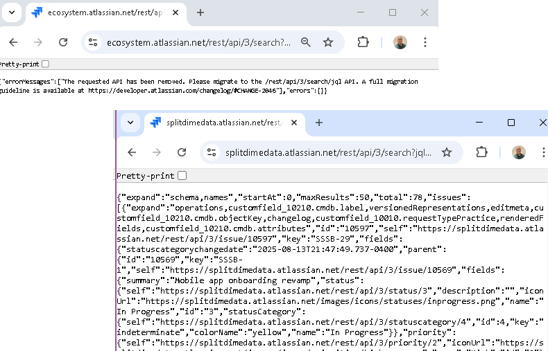

David Nickell
September 5, 2025
I would say the actual change is starting to be rolled out.
Approximately 2 days ago the "old" search worked for my site and the shared "ecosystem" site.
Today, it only works for my site.
Old Endpoint Format
New Endpoint Format

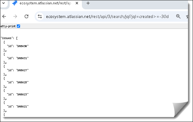

Sanapala, Sriman
September 23, 2025
Will we be able to get the complete JSON like in the 1st screenshot with the new end point URL i am only getting Id's like 2nd screenshot, Any suggestions?
M
September 30, 2025
Add query parameter fields to *navigable
As default is "id" only in /search/jql API.
Old API /search default for fields was *navigable
