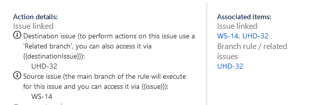

I reproduced it on my instance by building a rule for the scenario.
The showstopper is that the rule is executed against a branch - which in your case is always the sub-task.
It was not possible to link the story to the parent of the sub-task.
The parent issue in that case is the one which holds the sub-task. From Automation's perspective the issue (including the sub-task) is referred to as "Destination", though.
All the tests were based on the guide here:
https://blog.codebarrel.io/how-to-use-the-linked-issue-trigger-in-automation-for-jira-1616b68c2d6e
The output looks like the following from logs:
Overall I believe in that case one is running into the limitation:
Branches are isolated
Any changes that occur in a branch will not be visible to the main branch or other branches.
Mentioned here: https://confluence.atlassian.com/automation/working-with-related-issues-993924648.html
